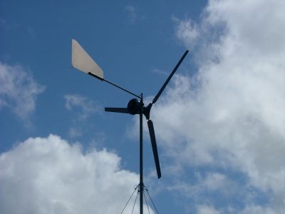

Well it happened, the yearly wind change. For the next 6 months the wind will be blowing from the south east, and I live on the north west side of a hill.
Last year the HAWT didn't move once for months, thought I remember the Lenz windmill on its stumpy little 7 foot tower was running every day. So this year I decided to take the HAWT down and put the Lenz up in its place. Even if it only made a few watts, at least it would be spinning around and looking the part.

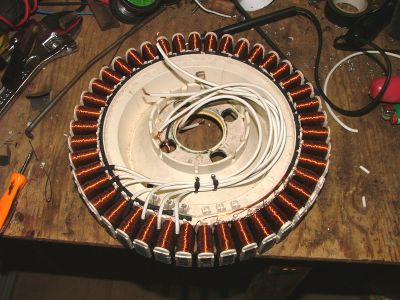

First up, since this Lenz is a low RPM machine, I re-wired a 60 series stator as a 7 phase cogless 6 pole. This will give the best voltage at low RPM, and a 7 phase conversion means no startup or running cog. Startup cog was never a problem for the Lenz, but the cogging did make a lot of noise in those big wings, so I figured a cogless F&P would work better.

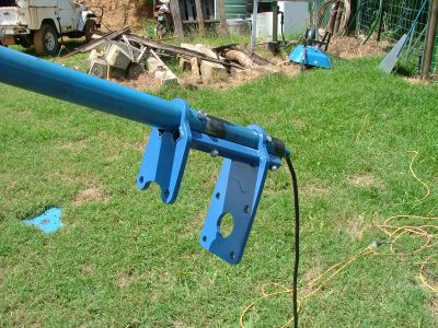

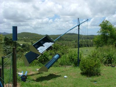

On Sunday I droped the tower and removed the HAWT, then fitted this bracket to take the Lenz. I wanted to keep the mast head intact so it would be easy to refit the HAWT when the winds return in September.

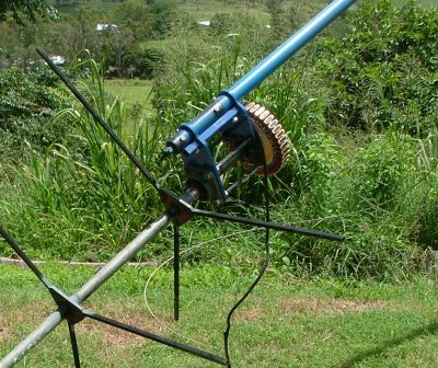

Here is the F&P stator and Lenz struts in place.
And all together. There was a bit of weight in it all, the tower was starting to bow.

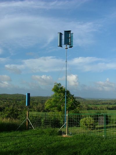

And up in the air.
So fars its going good, I had the PicLog windmill logger on it today to get some readings, very little wind, but it still made 14 watt hours for the day, and peaked at 22 watts a couple of times. Remember this is only a small windmill, 1.56 meters square compared to the HAWT's 3.8 meters squared. The HAWT would have made no power at all today.

The F&P vibrates as it rotates, cogging we call it. Or at least the standard 3 phase version does, the new 7 phase version has no cogging.
When I first built the Lenz2 I used a 3 phase F&P, and the cogging vibration went up the drive shaft and into the wings of the Lenz. Now these wings have a large surface area, and they acted as speakers, radiating the vibration from the F&P. So it made a very loud drone noise, a bit like a 4 stroke motor bike.
A 7 phase or decoged 3 phase F&P gets rid of the problem.
