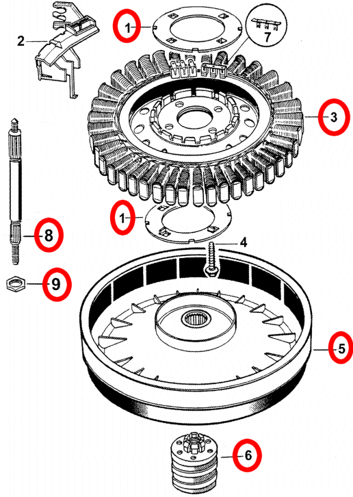

I have one of the new cogless rotor and hub and now I need the shaft and shaft nut,would anyone have the part # for them? I will be ordering from F&P in the USA. I did get the rotor and hub from ,they deliverd right to my door in less then a weeks time.

All I have is this exploded view, but it doesn't show part numbers unfortunetly. You could take this to a supplier and say you want part 8 shown.
You said you have the new cogless rotor AND hub. Can you confirm that the rotor has 16 magnet tiles, and the stator has 36 poles. If so, then dont wire this as 7 phase, it wont work. The 7 phase conversion will only work for a new hub ( 16 magnet tiles ) and old stator ( 42 poles ). If it is a 16 magnet hub and 36 pole stator, rewire as 3 phase.

Part 8 & 9 is what I need, Dwyer, I am in canada b3z 2j9,if geeting them shipped here is not a problem I will get them from you. Thanks
Glen,my mistake saying 7p3p,what I did was divide into 6 groups and rewired 6p3p?
