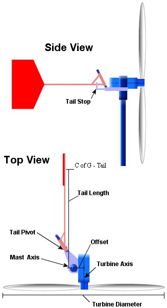

Please note the Tail Length diagram is incorrect also. It should be:

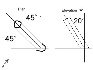

This sketch may also be of assistance:
Let us know how you go with that please.
