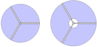

I want to make a blade extender hub arrangement to suit the F&P. This will let me move the blades out from the center to gain a larger turbine diameter, and adjust the angle of attack. Did some maths and thought I would share the results.
Now I think these blades are about 1.05 meters long and if mounted on the chinese hub, give a blade diameter of 2.2 meters, meaning they are mounted about 50mm from dead center. If I extend the blades out 200mm, this will give a diameter of 2.6 meters. We gain some swept area on the outside diameter, but loose near the middle of the turbine as the blades no longer sweep this area. But this is not worth worrying about, the root area of the blade makes very little power, while its also the most difficult to shape correctly.
We can work out the area lost in that first 250mm from the center using Pi*sqr(radius), our radius is 0.125m ( 125mm ) so 3.14 * 0.125m * 0.125m = 0.049 square meters.
The area gained on the outside diameter = (Pi*sqr(New Radius)) - (Pi*sqr(Original Radius)), so ( 3.14 * 1.3
* 1.3) - (3.14 * 1.1 * 1.1 ) = 1.507 meters squared.
All up, by moving the blades out 200mm we have gained 1.507 meters squared and lost 0.049 meters squared, giving a net gain of 1.458 meters squared.
The total area for the standard 2.2 meter blade was 3.8 meters squared, moving the blades out 200 gave a area of 5.3 meters square ( minus the 0.049 we lost near the middle ).
The other advantage is the blades need less twist the further they are from center, so by moving the blades out and adjusting the angle of attack to suit, should give a big performance increase and less noise. The mill may spin slightly slower, but would have much more power.

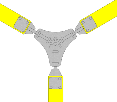

Now that I have a set of the blades, I can get stuck into mounting them on the F&P windmill. The hub I've designed up will give a diameter of 2.6 meters, and will let me adjust the blades angle of attack. With any luck I'll get these parts laser cut by the weekend.

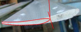

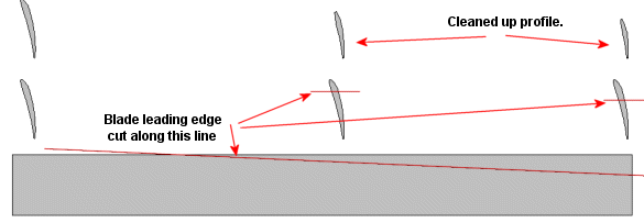

Now to the reshaping, these drawings may not make sense, but I will cut a wedge out of the leading edge of each blade, and then reshape the leading edge where it was cut. This should be a 10 minute job for each blade ( a power file helps ) and will give twist over the blade length.
This photo of the end section should explain how I'll reshape the leading edge.

Hi Glenn,
Just a thought from lookin at your last photo. Propellor blades or wing tips that end abruptly as in the photo generate more noise and ineffiencies through the equalising of pressures around the tip instead of the airfoil creating a vortex.
For me, the natural tendency is to get engrossed in the profile and angle and forget to consider the losses around the tip which make that portion of the prop usless and noisy.
There are several ways to overcome/reduce this vortex on a wing, but on a propellor the only one I know of is rounding off. Say like the shape of a Spitfire wing tip.
I reckon trimming to this shape will add to your improvments and further reduce noise.
Edited by Gill 2007-01-31
Cheers Gill _Cairns, FNQ

Yes for sure, I agree. Rounding of the tip will help. I was also thinking of adding a small cigar shaped winglet, but bonding could be a pain and I wanted to keep the modification simple.

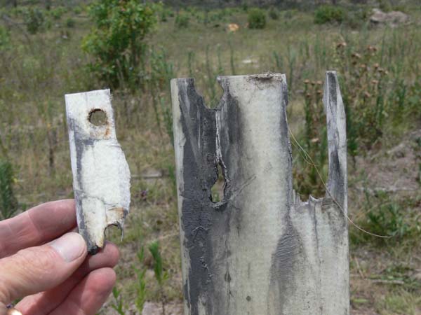

If you are going to use the Chinese blades, take care, see photo. The bolts were still in place but blade was not. I am thankful it didn't go thru one of my solar panels.

Thanks Magooly, I am a little worried about water ingress into the fibreglass. Trev, could you suggest a way to seal these blades once they are ready to mount on the windmill? I was going to paint them, but I wonder if there is something I should do to those mounting holes first?

It is not necesary to do anything? nothing is going to change its strength. Water will not effect it.
However the resin will no doubt be polyester which will deteriorate is sunlight, so a coat of paint to stop the sunlight getting to the resin will make them last longer. The best (longest lasting) paint is two pac and possibly should have an etch primer underneath. Anything will do though.
Mogooly, any ideas why it broke??
