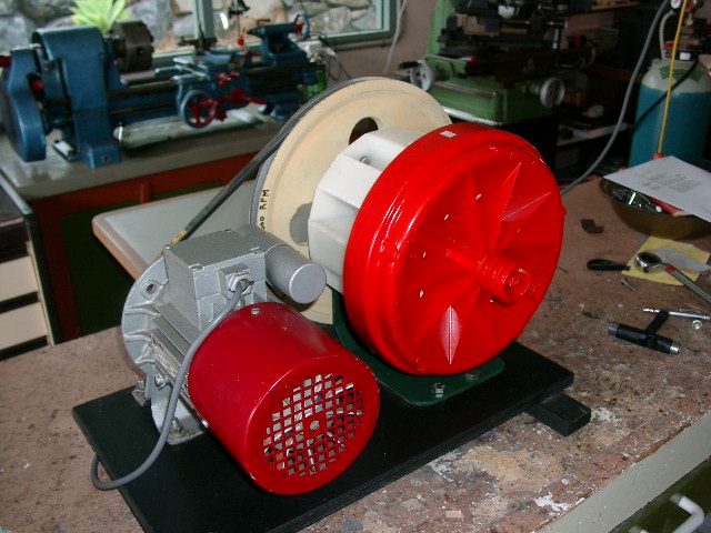

Well, just set it up on the bench --- get around 150v plus out of it just by spinning it by hand --absolutely no cogging at all.thing nearly free wheels at very low rpm
But.................. connect a battery to it -either 12v or 24v and whammo, can hardly turn it------soooo, it looks like I'm in for a re-configuration of the pole windings

hi Kiwijohn, Thanks for that ,I didn't have a load connected ,but maybe I could install another stator and rotor on the other side of the shaft and see what happens . I could short out 1 phase ,this should give it a load.
(I just edited a previous post to show the testbed,smallish drive motor ,but does the trick for evaluation ).
