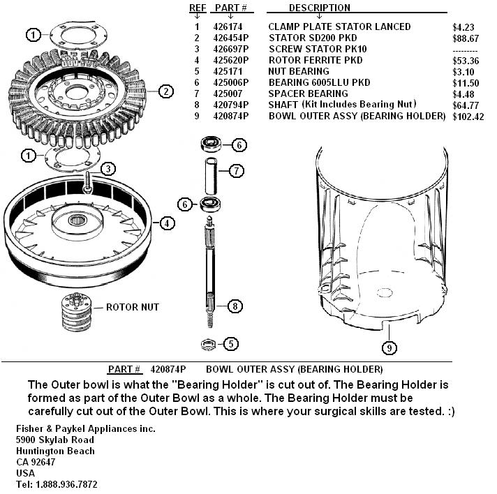

I just recieved my new 36 pole Stator and new Rotor.
S&P Parts place said that some #s have changed on parts.
Stator Part #420775P changed to #426454P ....and
Rotor Part #420774P changed to #425620P
I found a F&P parts place in California USA, if anyone needs the info here it is with part #s. I believe the part #s have changed for the new Stator and Rotor and are reflected in the pic below.
I just got rid of the diagrams I posted here and am directing to your new drawings Gizmo. Nice work! Thank you.
New 36 Pole Stator Wiring Diagrams
Edited by Tinbender 2008-03-06

You've done your drawings as a 6 phase alternator, but its actually a 3 phase alternator, so dont go cutting any wires just yet. Ignore the 7 phase conversion page, its only applies when you use the new magnet hub with the old stators. Instead look at the 3 phase pages http://www.thebackshed.com/windmill/FPRewire.asp
36 poles mean more options when you come to re-configure the stator. 1 pole, 2 poles in series, 3 poles in series, 4 poles in series, 6 poles in series and the standard 12 poles in series. The old 42 pole stators gave less options, 1 pole, 2 poles in series, 7 poles in series and the standard 14 poles in series.
So it should be a more flexible alternator with respect to output voltages.

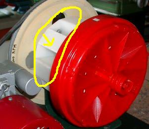

Posted: 06:00pm 01 Mar 2008
Bruce... What is this part you used here on your testbed? I've got one of the old bearing holders that was cut out of a whole tub, but this looks like a different type of bearing holder that would work well for what I want to do.
If it is a bearing holder do you have a part number so I can order one. Looks like I could easily mount it to wherever I wanted.
Brian
Edited by Tinbender 2008-03-03
