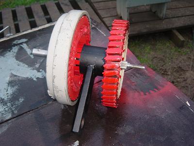

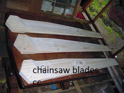

Hi all my first mill is dead so built new one will post pictures as they come thanks to all the help you will see my poor copies of your hard work started with new blades.
Now a motor.
I know i am going over old ground but canot bring myself to buy chinese yet...

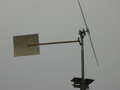

The F&P is a proven performer. Keep up the good work. Give your self plenty of clearence between the blades and mast.

Thanks bob / jim mill is up here is a shot of clerance I may have got carried away and lose power but once bitten buy tower contact twice shy.
See the crows nest tower dos not hinge yet.

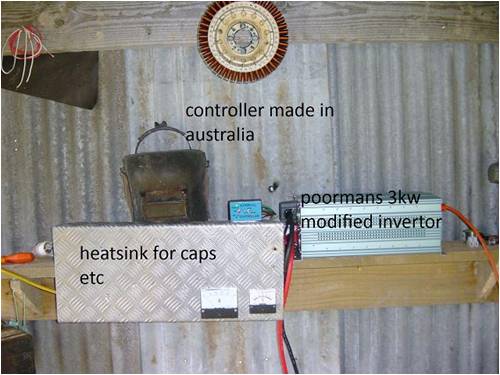

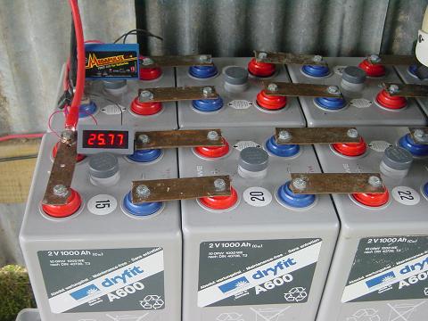

And my bank 24volt

Nice setup, perhaps roll off a bit of that tilt 1' should be heaps with those blades.

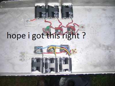

I couldnt be bothered working out if your cap doubler is good but looks about right.

100S wired in 2x7C Delta would make some wicked grunt for the top end and I'm thinking a stock rewire in 7x2c would give a really early cutin to boot.
Only time will tell.
Phill was adamant with mine that an 80 and 100 combo was the go, but i didnt reckon there was much in it, the two 100S one in star the other delta would have been AOK.
FIgures mate figures!!!

Caps are 330uf 400v two for each phase motors at the moment are 100 in delta and
80 2X7C star.
Have noticed one cuts in early not sure which but stalls blades am going to change the 80 to delta and hope I get the right one.
The best figures so far is when I disconected one stator let it spin up a bit then reconected it it held for about 10 seconds at 18 amps 26 volt was furling though.

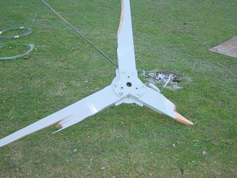

Have had enough wind to work out that this mill just is not giving me enough power!
so now new mill time. Chinese click finger and up it goes or rack my brain for ages build one that cost more and takes longer MMMMM...

The 100S in Delta will make good grunt into 48V, split it in half for 24V and double the amps!
go for the 80S in delta in 2x7C this will give plenty of grunt and an early cut in with the caps to boot and the 100S, go for broke,
2x7C in delta too.
Believe me I just doubled the output of that mill!
Look through F&P testing threads for every possible combo, with the CAPS you cant go wrong, what would have been a pig without them, makes it a machine that will match the wind power very well indeed.
I run an 80S 2x7C in star and a 100S in Delta into 48V thus, yours will run a config for half the volts and double the amps better
ie as suggested 2x7C delta for the 80S and 2x7C delta for the 100S too.
with this config I forsee a solid 22-24Amps.
It will make that at 500-600rpm and up.
I set mine to furl at about 700rpm thus even when spooling up and down with the furling action still making a solid 12A into 55V+ or 600W. (instantaneous) and if this happens over an hour would be 600W/hr.

Your help has been great karl but still cut in to fast with the 80 in half so made it 7x2c in star. with the 100 s 2x7c delta seams to work well with my blades getting 22 amps at 26.5 volts so much improved. Little woble with tower/tail so must re balance when it slows down gales up to 130 km hour for next to days acording to weather man

I like the distance you have between your blades and mast.
Once bitten twice shy so true.

OK weather not funny anymore several 20 plus year old pine trees down had to abandon mill to tie horse float to the ground and cheak house etc when left mill was reading 40 amps @ 27 volts Is this possible with my setup? reading karls posts this should not happen?? also volts are not being clampt with bank it rests at 26.5 but when mill goes hell crazy it goes up to as far as 33 this bank is 1000 amp hours mmmmm much to learn
and the recs and caps are very warm almost hot
these toys arent funny when they behave like this scary.

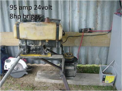

Update had 700 watt dumpload consisting of haligen lightbulbs blew them out and mill dos free weel untill gismo controller puts it back into bank at 26 volt so lucky i was there had car jumper cables handy very fast I connected them to the xternal shunt on amp meter and to bank
am going to fight to keep this one alive!!!
