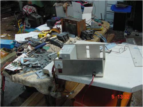

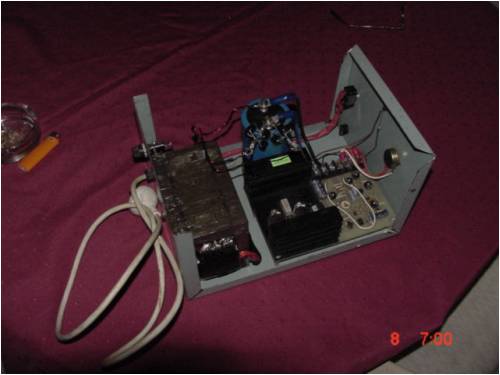

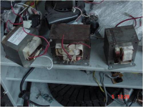

like this:
and this:
and using 2 lots of plates for a 1.5kw unit..... like this

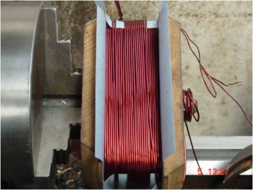

And here we are winding the primary for that big one. .... it's 1.8mm wire.
Those microwave transformers are the best thing I have come across for good laminates. Their original primary is no good for 240v operation, as it is designed for ferro resonance application (hence the shunt in between the windings). It is designed to run over saturated.... which translates to HOT.
So the windings are only good for spare wire. But the plates are great, and a lot of them use the same size stampings, so you can design your core for whatever cross section you want..... just keep adding plates until you get the square inches that you need to fit the windings in the window.
Strangely, for laminates that are welded together, the eddy currents are not too bad, although I like to separate them, and assemble them in the traditional manner. (the mess in the picture above)

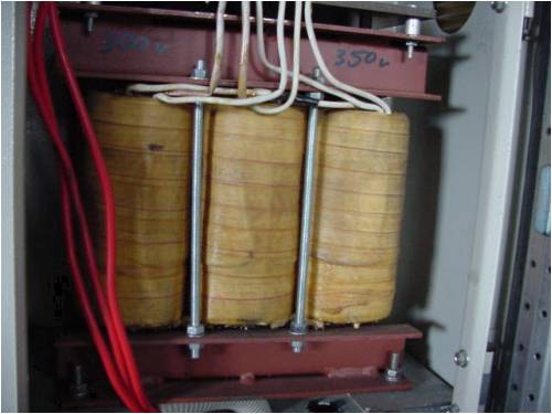

Here is the one off the AWP system.
