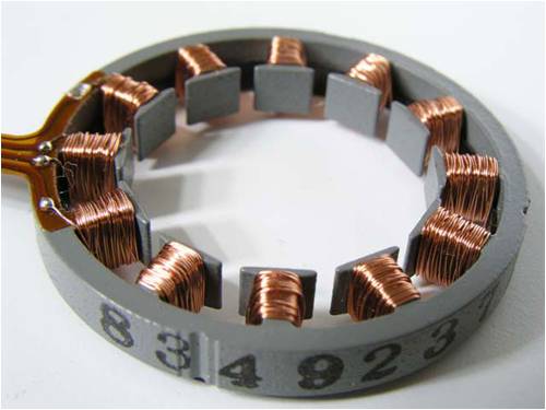

How cool is this?
This is a stator out of a computer hard drive. Looks almost exactly like the F&P
guts without any cogging iron cores (although they may actually be there, merely
hiding under plastic). Still, it's pretty cool that you could save weeks of shop time
short-cut by a little creative dumpster diving!
Just a thought. Of course, you know what they say about "idle minds"!
Edit: I just figured out that if 4 coils were wired in series and the magnets spinning inside the core were arranged properly, it would make this puppy a 3-phase alternator, right? (Thanks to Oz for that cool link!)

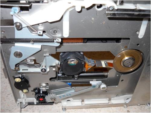

Err . . . um . .
Apparently, all roads do not lead to the Emerald City. Case in point:
I scored a throw-away-ready hard drive from a neighbor. I took it
all apart to find that cool motor pictured in the first post.
Ain't takin' stuff apart a gas?

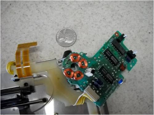

Here's the part I thought I was looking for. That's a quarter next to
it (American 25-cent coin) to give you an idea of its size.
As most are already aware, I'm into "small" but this is even beyond me. There's a country-western song sung over here and the guy singing says something like "It's okay to be itty-bitty . . . etc." so I just figured that if small is cool enough for the s*!t kickers, it's okay for me too. Well, small is cool, but this is way too small, even for me!

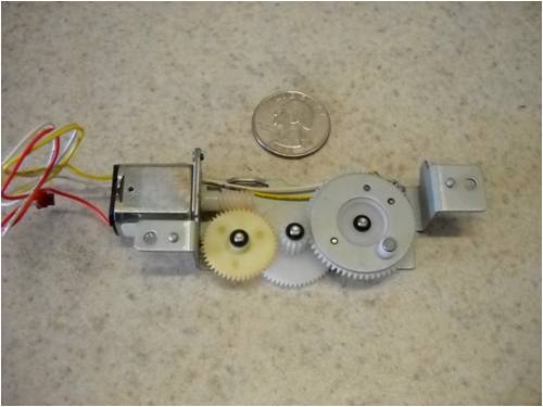

Don't quite know what to make of this. It's an itty-bitty electric motor
with a worm and down-gears. Too cool to toss. It's headed for my
"Damfino" drawer. Damfiknow what's in there!

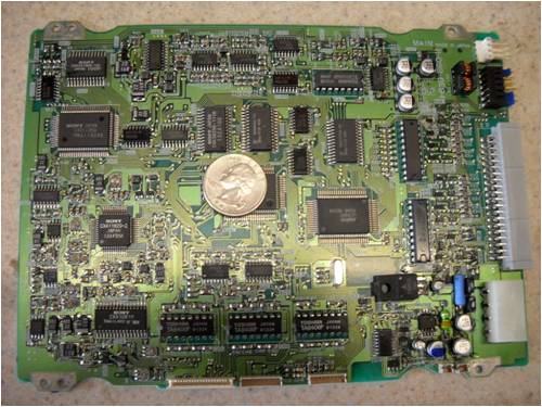

Remember that Barbara Striesand song, "Memories"? Here's some for
ya. This is the hard drive memory, I think. That's the same quarter
sitting there, by the way; everything here is rrrrrreally small!

So if you would have had a "Quarter" in the 1st photo with the stator, how big would the "Quarter" be? (How's that for improper grammer?)

Hmmm . . . . You know, that's a really good question. I got the picture off the Internet and just "assumed" it would be about as wide as a computer tower, like 3" or 3 1/2" or so.
Heck, I hope they're not all that small. What a disappointment that would be, eh?

You just have to love it when Mac finds a new toy.
They are the same as what some of us have used for ages in anemometers and phone charges, rotory encoders, etc.
You will find they are already a 3 phase motor and no rewire of the windings needed except for the same reasons as we do with a F&P.
You will find these sort of motors in many things from HDD, to pc fans, video heads..........and the list goes on.
A lot of times you will find there is 4 wires because they bring the star connection out and tie it to +v and then phase the 3 sets of coils in sequence with V- to give rotation.
If you want to use it as a generator than forget the star connection and rectifie the other 3 wires and ...presto.. instant generator.
Im just not sure what you will do with all the power you make.
Maybe dazzle yourself with a led.
They are cute all the same.

Where this all started was in my mind. Yeah, I know -- flag on the play! Anyway, Glen had a post in his diary about a motor that looks the same as the picture I posted and he said it was out of a hard drive, but the thing was like 12" diameter and even had a rubber wheel mounted on its perimeter. He was going to use it to drive a solar-powered car or something, I think.
So, I put 2 and 2 together (and apparently came up with 5!) and figured a hard-drive motor would be similar in size to the width of a computer tower and used that information to springboard myself into misunderstanding everything.

I have a similar stator in my hand at the moment. It measures 1.5 inches - outside diameter. It came out of an old cd burner. Hope that helps!

Steve_O
Thanks, mate. I threw the post up hoping to find one the size of Gizmo's. His looks to be about a foot across the middle, perhaps the size of an F&P (?) dishwashing machine motor.
As Pete pointed out, I'm all into small, but this is TOO small.
