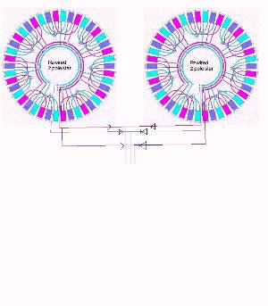

Posted: 12:29pm 30 May 2010
Hope the image comes throu as this is my first time. If it does would it work with the diods

Pic is not real informative, but looks like you have a series diode, in each phase lead from each of the stators. Not sure what you are trying to achieve with this?
I presume that you are hoping to use the star point as a centre tapping point for a 3 phase rectifier, on each stator. This is like a 2 diode arrangement for a centre tapped Xformer with full rectification, but for 3phase.
You may be able to clarrify.

Posted: 02:29pm 30 May 2010
Basically you are trying to reinvent the wheel....Why????
Just use 2 x 3phase rectifiers, 1 for each stator.
Then join the 2 DC positives together and the same for the negatives.
Dont worry about the star point (or neutral as you called it) there is almost no point in using it with 3 phase.
If your method was worth doing than many here would have done it years ago and it would be widely posted to the forum.
Pete.
