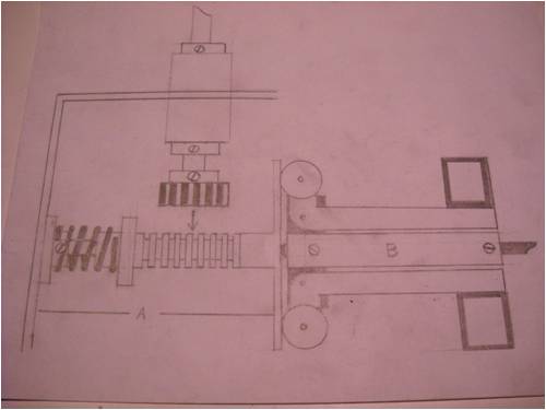

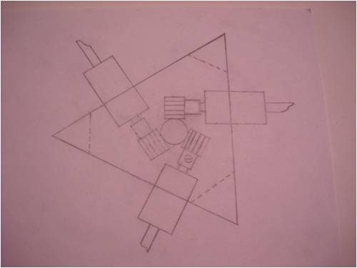

Study the following two diagrams I've drafted. I'll leave this here until I have the time to machine the thing. Right now, I'm waiting for materials to finish my axial-flux toy windmill as well as one that is iron-cored (and will likely cog like there's no tomorrow!). In the meantime, if anybody has any thoughts, post them here and together we'll iron out the details so when it's time for the build, the final product should work. At least, that's the plan.
This is the hub end. The large triangle is made of welded aluminum. The blades pass through a bushing, which is pressed into an aluminum tube welded to the aluminum triangle hub frame. A stop at both the inboard and outboard side of the bushing shaft keeps it in the proper position. There is a spur gear fastened to the end of each blade shaft using a set screw. I see now I forgot to draw two of the set screws in, oops! The spur gears are locked into a rack gear (like rack and pinion steering) which "floats" freely on the end of the windmill's shaft, positioned by a spring trapped between the outboard side of the hub and an inner, moveable hub wall that is controlled by flyweights (see second picture). The little dotted lines in the corners of the triangle are gusset welds inside the hub. These hold things true under stress.
From left-to-right we see the "A" portion, which floats freely on the windmill's shaft. The spring tries to force the rack into the "default" blade position (45 degrees to the wind direction). The "B" portion is locked onto the spinning windmill shaft. The two round things are little wheels, which ride on the "floating" hub wall of the piece carrying the rack gear -- the "A" part -- which pushes tension aft via the spring. The two dark square boxes on the "B" side are flyweights. The "B" part, being locked to the spinning shaft, twirls as the blades provide the motive force. As the weights spin, centripital force throws them outward and as this happens, the action moves the bell crank (lever) and the little wheels work in unison pushing the moveable rack hub plate and change the position of the rack, which in turn rotates each of the blade shafts in unison (or so the plan goes!). The picture shows two flyweight setups, but in reality, there will be three, each set 120 degrees from the other two.
Well, that's it. Now it's everyone else's turn to shoot at it and maybe we can come up with a better mousetrap, who knows?

Hey Mac, sounds like a runner. I'm wondering about over-speed protection though. Traditional furling? I don't know how having a system that promotes an ever-decreasing angle of attack as wind speed ramps up will survive long term, from what I've read (and understood).
Don't self feathering hubs start at slight attack angles and rotate away from the wind (towards larger attack angles) to decrease their efficiency? I know that a higher attack angle improves yielded torque (great for start-up) but at speed it is countered by the dramatic aero inefficiencies as air flows badly over the blade. I'd welcome correction on my understanding if I'm way off here.
I understand where you're coming from with the "start large (angle of attack) and progress to efficient" but I suspect you might need to limit the attack angle you end up at if you live in a windy region. Indeed, if I'm actually on the right path, the windier the set-up, the larger the final attack angle will need to be for longevity.
LukeEdited by montyLalor 2010-05-27

Hi Mac
The Idea of a regulating hub has been around for some timr now.
What is the best idea?
I liked your earlier idea "The Drill bit thing"
Teamed to:
(One) rotating plate. Keeping all 3 blades the same...
(One) Spring. Adjustable maybe.....
Starting out at (ABOUT) 45 deg. and droping off to Zero "or maybe even Negative" to slow it down. a person would have to do some expermenting, Speed regulation / noise.
Just a thought >>>>....
Ron
THE Pirate.
stealing wind & solar energy is fun

Both good posts; thanks each. Yes, there's more to this than I've posted, but I didn't want to belabor the initial post with too much rhetoric. I wanted the crew's input instead.
First off, I had thought about the over-speeding and decided I might be able to allow the travel on the rack to go to such a point that the blades went flat against the wind or even reversed pitch a bit. Flat, spinning blades present quite a large wind "footprint" in the wind, sort of like holding a piece of plywood at arm's length flat against a wind -- lots of tower stress -- but that's likely the case. I don't see any way around that one, except to limit the length of the blades.
The drill-bit thing I posted a while back in the days when Dinges was a regular visitor also passed through my mind, but that one is better suited for a single blade application. I've built single-blade windmills before using a counter weight to offset the blade and maintain balance, but these things scream and their speed is very hard to control. They basically have two speeds, stop and full-on maximum. Using the hollow blade-mount tube sliding down a drill-bit flute and twisting with longitudinal movement is a tricky thing to do to get all three blades at the same pitch at the same time. The machining has to be spot on and I don't know how wear might figure in, so that's one I'm leaving on the drawing board for a while.
Now that I think about it, the single-blade machine is somewhat of a constant intrigue. It has two really big problems or I'd build them all the time. The build is super simple, but they have a hard time turning (furl / yaw) and as the single blade passes the tower, the "wind shadow" of the mast, it causes the whole thing to bump. Kinda like "coggging" using magnets and iron cores does, this thing just "beats" almost sub-audibly, but enough to drive you nuts.
What doesn't show in my original posting is the tail. I also design and build sail planes (R/C) and have a lot of experience with "controlling surfaces" translating small movements into large motions. The tail on this windmill will have a rudder.
On one side of the rudder will be a "bell crank". That's a lever shaped like the letter "L" with its pivot point at or near the bend. This lets you pull one end in one direction and create movement on the surface at the other end at 90-degrees from the initial position.
In this case, I'd install a spring-loaded bell crank on the rudder. The spring would keep tension on the rudder, but it would be "pinned" in position by a little piece of round metal (a pin!). In the case of over speeding, the pin could be yanked out either by someone on the ground pulling the little string that dangles under the rig or by servo-mechanical means built into the fly-weight system. When the pin comes out of its land, the rudder slams to one side, turning the entire windmill out of the wind.
Unfortunately for this system, if activated, the mill would have to be reset manually, meaning either climbing the mast or lowering the windmill. Better than destroying everything, but a pain in the drain as well.
Something to remember here: Everything I build is really little! I like building little stuff, so increasing all the sizes to make this practical for someone desiring to generate "house current" on the order of being able to grid tie, would mean some serious re-engineering. It's one thing having 30-inch blades whirring around, but 10-foot blades are another realm altogether!
I suppose I could don the thinking cap and come up with a way to incorporate extreme movement of the fly weights acting on a cam or something that would gradually adjust the rudder to pull the thing 'gently' out of the wind's path preventing overspeeding, but like I said before; drawing-table stuff!
Of course, the basic idea presented here could be built into a design that doesn't require the reverse of normal, meaning it could be used to pitch the blades steeper as the speed increased, thus making it a true over-speed protection application. I just attacked it from the other side of the coin to meet my 'particular' need. Once we've hashed over al the "bugs", feel free to build and use the design however it fits your situation.

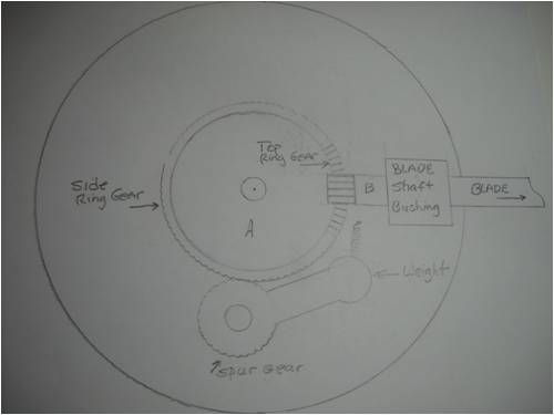

Simpler Design
Okay; I'm back with a much simpler design. The only really hard part is either finding and adapting the gears or making them from scratch. Broaching a top ring gear with a spur ring gear on the side of the same piece would be quite a "weekend project" but if anyone is up to it, be my guest. Here's a barely-visible sketch of what I'm up to:
The way this works follows:
First off, what is shown here is only one blade-pitching mechanism. In the final build, there would need to be three such items, each placed at 120 degrees from the other two, pitching each of three blades simultaneously.
As the whole shebang turns in the wind, the flyweight (labeled "weight") would be thrown out against the little spring, which tries to hold it inboard near the central hub. When it begins sailing outbound, being attached to a spur gear, which is meshed to the side ring gear of the main hub, it rotates the spur gear, which in turn rotates the central hub. The central hub sits on a ball bearing at its center and everything is mounted on a plate which also supports the blade shaft bushings.
On top of the central hub (A) is another ring gear cut into it's top face along its circumference.
At "B" there is a spur gear attached to the blade shaft. That spur gear is meshed to the top ring gear of the main hub and as the hub rotates, due to the action of the flyweight rotating the spur gear(s), it in turn rotates the blade shaft, changing its angle of attack to the wind.
That's about it; easy huh?
Like I said, the only "real" problem is broaching that central hub so it has a ring gear both on its side and on its top circumference. Because of this fact and that I already have way too many plates in the air, I'll likely use levers acting on pins for my first build of this sucker.
Stay tuned and as I find the time, I'll try to fit together something that works and I'll post it here. I'll likely just post the finished project and not a blow-by-blow build simply because the design will likely change by the time it's a done deal.
. . . . . Mac
Edited by MacGyver 2010-06-03
Copeville, Texas

Hi mac
Will that be able to control all three blades at the same time?
or will it be 3 seperate controls...
Ron
THE Pirate.
MacGyver
Joined: 12/05/2009
Posts: 1330
Posted: 04:19pm 02 Jun 2010
[Quote=wind-pirate]Will that be able to control all three blades at the same time?
Yup! It'll do all three at once and as a matter of fact, that's the ONLY way this will work. All three blades have to trim at the same time and the same amount or it throws the mill out of balance and it'll thrash itself to pieces sooner if not later.
I only drew in one section, cause I'm a bit lazy is all. Imagine, if you will, two more flyweights and two more blades attached 120 degrees apart on that same hub and you'll have it.
. . . . . Mac
