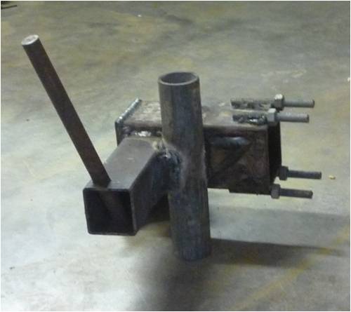

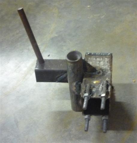

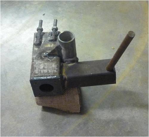

Here are some pictures, hope they can help.

Nice one Geoff, going along well.
Make sure when you're done to give it as best a clean up as you can
and I', a big believer in cold gal or hammerite, both seem to stand up to the elements well.

Ridge(heavy)is good, if you feel a little unsure about reliability or strength then do not hesitate to go a bit heaver especially with your yaw assembly.
Looks as though you've decided to base your mill on Glens well crafted machine. Not knowing the size of your mill makes it difficulty to tell for sure but I am thinking that the angled rod extending from your yaw assembly might be to light for a auto furling tail mount. On closer observation you will notice that Glen placed extra support in this area.
Be sure to allow enough room between the support mast and the blades, 5% to 7% tilled (blades)back away form the mast will usually help with blade to mast clearance.
