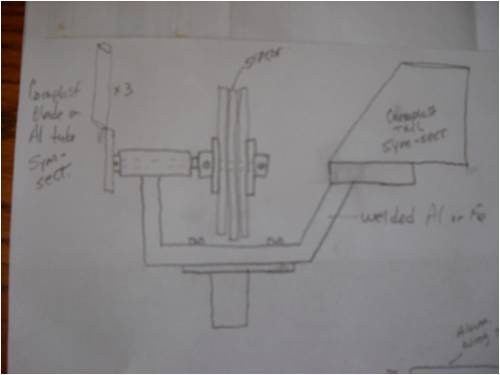

I couldn't figure out how to post a picture in the PM, so here's the sketch:
Sorry it's a little blurry. Also, disregard all the "notes to self" all over the thing along with the little bit of a picture at the lower right-hand side. I build R/C gliders and that mess in the corner is part of another sketch for a new plane I'm designing.
Anyway, the basic windmill layout is a welded aluminum frame. A Delrin bushing will house the main shaft and the magnet wheels as well as the stator are the standard ax-fx design. Blades as well as the tail fin are being manufactured out of coroplast (corofute to some) plastic. The blades are one meter long with an aluminum spar and will weigh in at around 12 ounces each. Both the tail and the blades are to be symmetrical section. I am not using any yaw gear as the thing is so light, I'm just not worried about over-speeding. This is an up-wind design.
I will be installing "stops" at 180-degrees atop the tower to limit the rotational movement so as not to have to worry about tangled wires or having to use slip rings. The mill will have free rotation within these limits and will be mounted to face the "typical" source-direction for my area.
I'll do a complete step-by-step tutorial with pictures as I build it, posting my progress here on the 4m and a You-Tube video when it's flying. It'll be a while, so if you're a part of the "hide and watch" crew, make sure your cookie jar is full!

MacGyver,
Looks like it would work just fine but a few comments.
-You won't have any means of furling. 2m rotor is pushing the limits of a turbine with no overspeed protection.
-You'll need to mount that stator to something. Should be easy enough to tie it to your main frame, you probably just didn't get around to putting it in your drawing.
-Delrin bushing? Is that for your main bearing system? Bushings would be a non starter and you'll want some good tapered roller bearings. Cheap enough but a little extra work.
Just some thoughts.

Mac it sounds like too much work for a 2 meter
turbine. If you are not worried about over speed
then you must be thinking of just flat straight
blades at and 5 degree angle or something with
a tip speed ratio of about 4.
If you are going to all the trouble to build
an axle flux alternator you will want lift
to get power out of it and you will need it to
furl unless you don't mind it burning out.
For a 2 meter machine you might be better off
just finding a suitable motor and let her rip
with no furling and a cheep prop. Been doing it
for years for a close to the ground unit.

Thanks for the comments, but I like to build stuff and especially like to build stuff from scratch.
I design, build and fly R/C gliders and pretty-well know my way around wing design and aerodynamics. These "blades" will be made of 2 mm coroplast, which is similar to plastic cardboard only with square holes.
In response to the "lift" comment, I've tried that and what I found is that as the speed of the rotor gets really high, the amount of lift created by say a Clark-Y wing section, will try to bend the blade. For that reason, I've decided to use a symmetrical-section design. I can build one of these blades in about 10 minutes start to finish (though that took a while to get good at!).
The blades will be on the order of "high aspect-ratio" design and no wider than 3 inches at the root (inboard edge). When I said they'd weigh in at 12 ounces, that was a guess, but each blade will certainly weigh no more than 14 ounces. I'll weigh one when I put this thing together and show a picture of it on my mini electronic scale so folks can see its actual weight.
As far as burning out my alternator, I plan on taking care of that with switching gear. Again, this windmill will be atop a very short tower (no more than 20 feet tall) and if the blade length becomes problematic, I'll just shorten it; easy!
As far as building an ax-fx alternator being a lot of "trouble", relax. It's no trouble at all as have a great coach who lives on Flinders Island, Tazmania. There's nothing he can't fix and he's always willing to lend a hand. You know who you are, coach, and thank you in advance!

Looks like the basic layout is a fair design from this picture.
Perry is correct, stator needs stabilization, and if you wish to use journals for bearings, then you will need to guarantee the thrust bearings/washers (or whatever you have in mind) will hold the rotor disks with well less than .25mm linear movement.... or you may interfere with the stator..... not pretty.
Now it is a matter of building it, and finding out how many turns/coil you will need.
From scratch is more fun for sure.
Do you have a guestimate of the TSR of your chosen blade design?

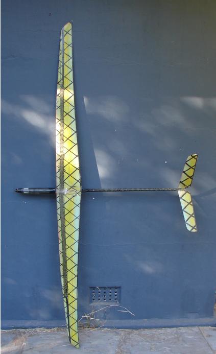

Here is a pic of one of my own design gliders, I made in 2004. All hand made, including carbon/kevlar composite boom and fuselage. This is 1.8m span, and weighs in at around 400g, with all gear. The 1piece wing tapers from 10mm thick section at the root, to 3mm airfoil at the tips. The tail feathers are 3mm tapered to 2mm foam cored. All the black, is carbon fibre. The criss-cross surface spar system is now used by top commercial designs.
I tried making a foam core, carbon/glass bagged airfoil turbine blade in a similar fashion to these wings. Wood is better, and much cheaper for a turbine blade. Weight is not as critical a component.

Gordon:
I forgot to compliment you on as near-perfect a glider as I've ever seen. I pride myself in doing "neat" work, but your craft is exquisite! I like to crash stuff too much to be quite as elegant.

I thought you would appreciate the lines of my glider. This model had a Fluoro RED leading edge I painted onto the foam wing core prior to bagging, but in the 1000 or so hours this model has flown, the sun has faded the colour. The curved wing trailing edge while maintaining the knife edge thickness was pretty hard to get right as well.
Good luck with the Coro-plas, and if it doesn't go so well you can cross it off the list.
