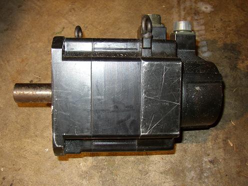

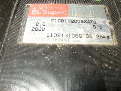

Something like this.
This is a 6kw motor. 6000watts. 200volts @ 30amps. 16volts @200rpm and 30 amps is just the starting point. You don't want to go over the name plate rating but really it will do 5 times as much with the right prop.Edited by 97fishmt 2010-05-06

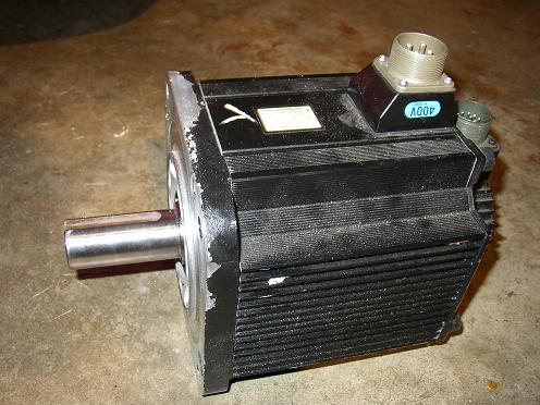

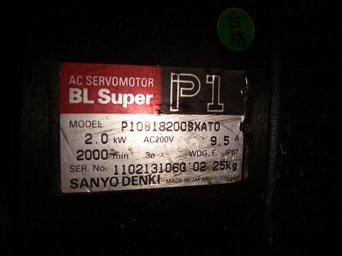

Or this
You can see this one needs a big prop for the 150 rpm cut in.
So a small package for about a 400 watt machine. But still
probably an 8' prop. I have had this one up with an 8' prop
and it did very well in light winds on a test stand. I saw
10 amps easy into the battery. The prop needed better balancing
so I haven't played with it since.

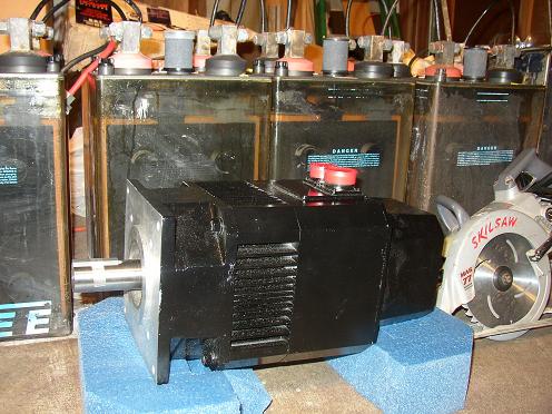

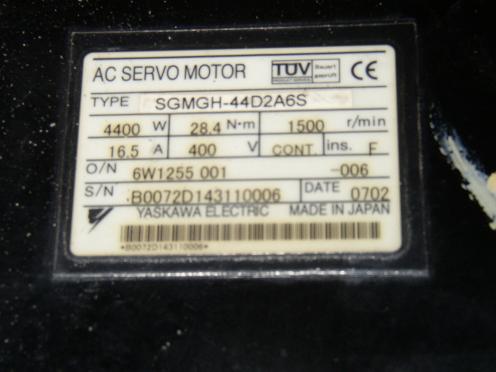

To get this.
This is a 9kw motor and I have seen over 100amps out of it at 15volts.Edited by 97fishmt 2010-05-06

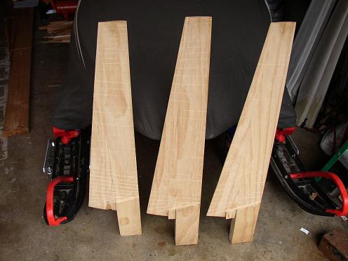

thanks for the encouraging words! i hope it works awesome! hits 24 volts at 240 rpm. 8.5 ft. dia. just got a layer of fiber glass on the blades the other day. lately, i've been trucking away at it for sure! hoping to have it up by june 19th!
