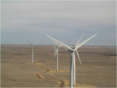

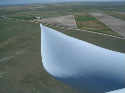

If your interested in this kind of stuff here are some old pics from the GE days.

Nice view from the top.

Whoa -- that picture of you stand on top of the nacelle scares me. Heck, I get dizzy just using Google Maps! I'll stick to my little backyard toys.

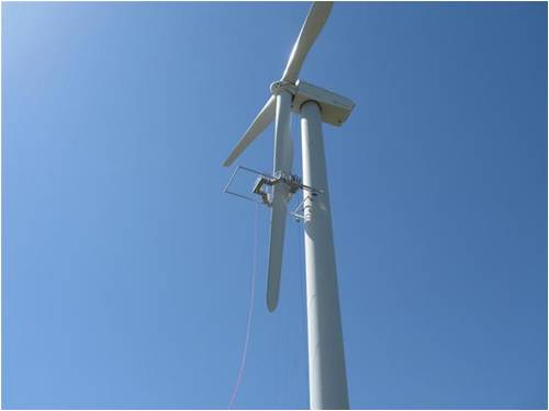

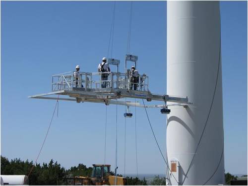

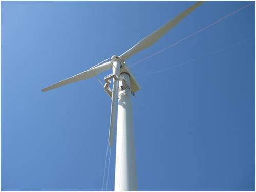

Here's a few more pics of a new blade swap method I helped develop where you can change an individual blade instead of flying the whole hub. Saves about $100k per blade. A big deal when you do a couple hundred blade replacements a year.

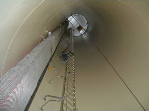

Definitely worth it! 85 meters to the top. Three sections as shown below and 2 more shorter ones. At least you get to rest at each section. It's funny because most of the people I climb with are the site techs and they are young and in shape from climbing every day. One day I smelt this burning smell inside and got scared but it was just the tech stopping and waiting for me and having a smoke on the deck above. Meanwhile I'm panting and on the verge of throwing up something I ate 14 years ago.

Hi Perry,
Do you have any more info on that blade swap method? Looks very interesting! How do you lower the blade? What is the blade tied to when you lower it?
Does it only work on the GE WTGs?
Cheers,
Adam.

hey Adam,
You see, the problem with blade swaps is that you need to fly the hub and replace the blade on the ground. This requires at least a 120 ton crane as well as a smaller 40 ton hydro to pick the blade, (swing the rotor to the horizontal). More often than not the cranes sit idle racking up full pay until winds drop enough.
This method uses ground based winches with long lines to raise and lower the blade. The lines pass through snatch blocks attached to the hub.
GE showed a video of the whole process at last years AWEA conference.
The platform you see in the pic's was provided by a 3rd party and are becoming pretty common in large wind. Mostly used for blade inspections when a ground based telescope won't do the job. We used it to stand on during rigging. Lordy that was an experience being on that.
