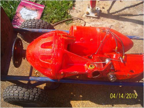

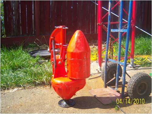

hi my old wind charger is not longer in service.. today sound like the gears are broken on the transmission so now is down. it will be on ebay for sale the problem i don't have any clue for what price... i will keep the tail if you have knowledge for price let me know....thank you

It is the right colour to attract someones attention. Not sure it is worth fixing, so how much does it weigh [boat anchor], or maybe a static display in a museum may be the go.
The right person with the right equipment could always repair this type of machine, but there are plenty of replacement options that would be more viable.
Shipping weight will probably be a problem. Hard to put a real $ value in it.

May be you should open the gear box and check it out first?

aim a fried to open the transmission and to put back will be a problem ...

thank you ..to all , today i will open the transmission to see what is broken. photos will be post.
