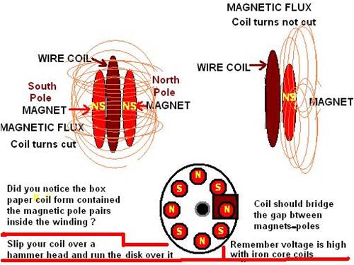

I am new to this and would just like some very basic help. I have loads of enameled wire and 12 Neo magnets ( N35 i think ).
I first copied this set up
http://www.eskimo.com/~billb/amateur/coilgen.html
and got some nice voltage out of it from hand turns. Next i tried winding a single coil ( about 200 turns small gauge ) into an oval shape the center hole was about 1 inch the same as the width of my disk magnets. I then gave a quick wave of the magnets past the coil ( coild laying flat down, magnet just above waved past ) and i recieve zero voltage, i glued all the magnets to a CD in an alternating pattern the turn the CD with a drill above the coil still no voltage. I check the coil was making a proper circuit and it was - can anyone tell me what im doing wrong otherwise i dont see how to make a small wind turbine at all.

how are you checking the voltage ?...it will be an ac reading on the meter you use
maybe double check the n/s n/s pattern by holding a magnet and passing it over the magnet layout...it should feel like ripple effect...push /pull
as long as one north pole passes one leg of the coil and one south pole over the other at the same time you should induce some voltage
with the neos you should be able to induce a reasonable current...enough to pulse a led or small low voltage/ampage bulb

I am using a multimeter set to 0-200 volts AC scale. With the simple carboard set up thing it was giving about 1-2 v ac.
you mentioned "as long as one north pole passes one leg of the coil and one south pole over the other at the same time you should induce some voltage "
my current set up has only one magnet passing over the coil at any one time, and yes i checked the NSNS pattern.

the mags sound right ....now it might be best to rewind a new coil (probably much bigger) so as the different magnetic poles pass over the coil legs at the right time
if each leg of the coil is roughly the same thickness (edit. width) as the mag passing above it ...things should start to happen
dont worry too much about the coil neatness .but it helps if they are ...your experimenting ...a much much lower voltage scale on the meter would be better maybe 10v ac

I would think your coils will need to have a steel plate behind them so as to give a return path for the magnet flux as it passes over the coils.
Pete.

if you have a steel plate maybe you could use it as a magnet rotor...this will focus the magnet field much better than air , something similar to an air core alt...or use some kind of simple laminate steel at the back of the coil Edited by niall1 2010-04-11

Mac, the idea is the coil remains stationary while the magnets *and* the steel back plate rotates on the same axle.
Of course, it *will* cog if you have a fixed steel part with a magnet rotating past it.
