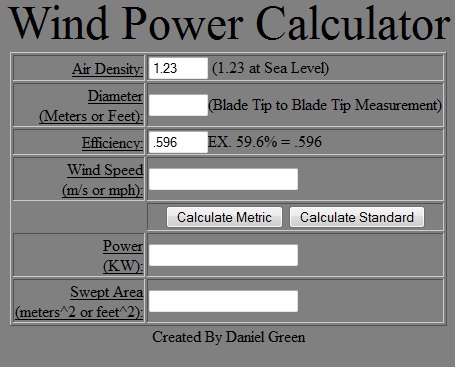

I imagine for beginners that one would give most a headache. lol Give's a lot of information, some just like sweet and simple. Here's another one I just made in JavaScript it features the ability to enter either your numbers in Metric or Standard and click the appropriate button. 2010-04-04_145329_WindCalculator.zip
All this one requires is a web browser. And is tiny.Edited by GreenD88 2010-04-05

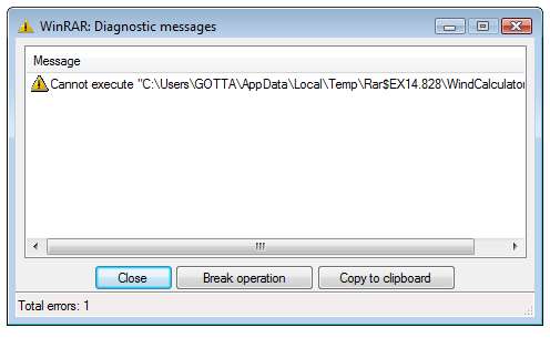

Posted: 05:57am 04 Apr 2010
Its Broken!!
I get this when i try to view it.
Pete.

Hmmm Might be cause of winRar, but when I download from the link it works fine but I use
7Zip. I'll recompress it with WinRar and see if that fixes it. Here's the .Rar file from WinRar.2010-04-04_160704_WindCalculatorRAR.rar
Here's a Screenshot of the Browser Calculator.

GreemD88,
I downloaded your Calculator-(Not the open office one.)
with Firefox. on XP, No problem. works great for a ballpark estimate. a great tool for anyone shopping to buy a mill, this can quickly tell what is needed to satisfy requirements in terms of size for output. Thanks for a good freeby. The Altons Calc is a designers tool and would be the one to use if carving an efficient blade set for a specific Loading at RPM

That's what I was thinking, When People see a wind turbines performance they can type in the diameter and rated wind speed and see if someones lying or not ;)
Here's the basic Formula P=0.5*rho*A*V^3
P = Watts
rho = Air Density (kg/m3)
A = Swept Area Meters Squared - pi*r^2
V^3 = Velocity Cubed. m/sEdited by GreenD88 2010-04-06
