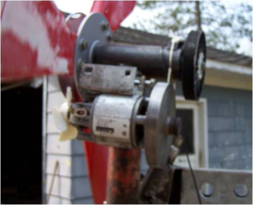

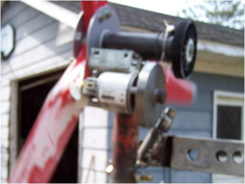

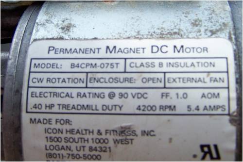

I guess I misread the motor as you can see...it is a .40 not a 40.....
here are some pics of it...
Thanks,
Gary

Its not an over large motor for the blade set you have and with a 1:4 step up ratio it will take 4 times the wind speed to start it compared to a 1:1 ratio.
Any cogging effect or drag will 4 x greater to overcome.
Looking at the photos it dont look like a 1:4 ratio.
Pete.

hi Gary...
those blades do seem very similar to the ones i had....if their the same batch they probably have a fairly high tsr and minimal twist ...unfortunately this isnt going to help their start up much
even with just hub bearing drag higher tsr blades can take a couple secs to get going...not much grunt in there till their up to their ideal speed
maybe try 1:2 as an experiment ? ...feel her out a bitEdited by niall1 2010-04-04
