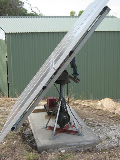

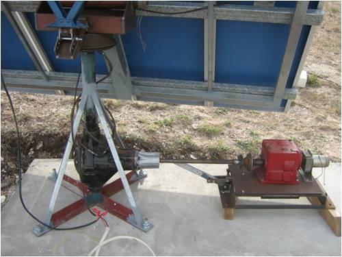

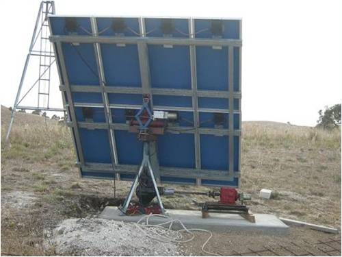

The reason i asked about moving the solar panels closer to the mill was to consider putting them on a tracking system which will give you around 25% more power out over the day.
There is this funny stigma that the panels on the roof is the best place for them........What is 15 foot going to change in output?
If you have the space and ability to build a tracker than i would go this way.
I built one for a friend who lives off grid, it might not be the best design but it works well and gives 25+% return.
My thoughts were strong and robust on a very cheap budget. It needed to with stand a high wind area.
I used a car diff and a gearbox that was lurking under the bench with a 400:1 ratio.
We had intended to have tricky electronics tracking the sun and wind, but with tests done, we settled for a manual adjust tilt (once a year) and a basic system that moved in +/-15 minute intervals a set distance throught the day, then returns to a given point at sun up.
There is 2 travel times used ..summer and winter.
There is many trackers others have built on the forum.
Some have many more features, and all work to a positive result and is a credit to the people who constructed them.
Mine was agricultural, strong and cheap that gave a 25% more output return.
Some more food for thought while you weigh the options up.
Maybe it is worth running a 240v ac cable 600mm deep, if a tracker suits location.
Pete.

i didnt bury my cables 600mm deep but the rules for LV and HV are the same ANY buried cable is technically supposed to be 600mm deep.
PVcool do some great trackers for $1000 AUD (that will hold about 1.5KW (12m2) of panels plus pole and a few hundred bucks in concrete.
Kinda convenient if you havent already dug the hole for your wind turbine, could do both at the same time.
This will give your solar 30% boost and keep all the equipment in one spot albeit a walk from the house

I like that tracker.
What if you put some white colorbond round the perimeter at 45 degrees, so the PV panels become the base of a bowl. I wonder how much the glare would increase output. Another 20% would be worth the effort, assuming the thing didn't overheat in summer... (Since you're not using mirrors, it might not void the warranty.)
