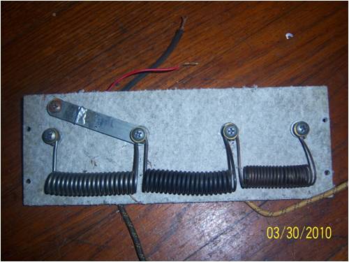

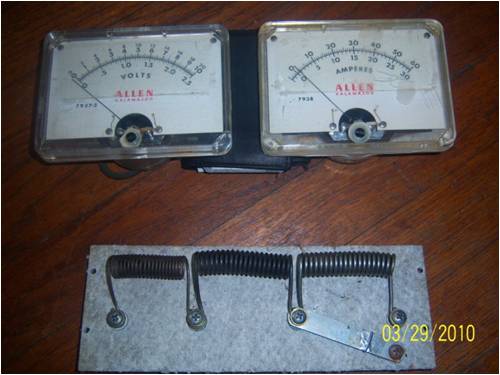

i found one old amp and volt meter dc both and a coil like spring i thing is lake a resistor with different size's look like the one come from a heater this come inside with the volt and amp meters ...i will take photos ...by the way thank you for all the help from each of you.
Posted: 04:11pm 30 Mar 2010
I would think the coil like spring is a shunt resistor for the amp meter.
The power is passed through the shunt and the amp meter is connected across the shunt.
This allows for mV meters to work as a amp meters with all the current flowing through the shunt and not the meter.
The photo should tell us.

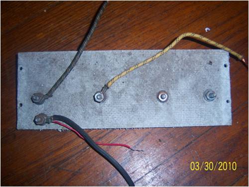

ok this is the photos

That looks suspiciously like the asbestos you should not be messing with. take care when you play with old stuff.

This appears to be a resistor or a old system to regulate voltage to the fields of a large motor controlled by a rheostat (not in photo) just guessing . it appears that the lower scale on the ammeter has been the one in use at the time.
Notice the 2 coils look burned The third one does not and the metal jumper is tapped between coil 2 and 3. The meters in the photo may not have a shunt inside , If not they will be destroyed when hooked to a battery.
I suggest you find an ammeter in an auto parts store or salvage yard, customized instrument panels, Some have amp gauges calibrated in 5 ampere divisions.
this will get rid of the old hardware and guessing how to hook it up.
EDIT; Changed "shunt resistor" to "resistor" and "shunt resistor" ro "shunt"Edited by Greenbelt 2010-04-03

yes is from old battery charger....ok i will do.Edited by DTV004 2010-04-01
