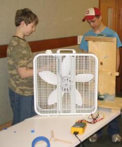

I’m going to try to explain better what I need:
I have to design a Turbine, rotor, windmill, fan or whatever name you want to give it.
I have to create a wind turbine-like object using a CD and other materials. During competition, they will attach your device to a CD motor. You will then place a fan in front of your device and turn it on. Your blade will spin therefore creating voltage. The higher your voltage, the better your score. I must include a standard CD in my wind turbine.
I have to use a CD that can be modify, but not the hole because this has to be attached to a device (CD motor) that the Science Olympiad is going to provide to the teams at the time of the event (I made mine to test my windmill with a CD player parts).
The size of the blades on the windmill has to be measure between 20 to 24 cm and the only material that I cannot use is any metal or derivate.
So I have to design a windmill that has to be attached to the Olympiad device. I can play with the high and angles of the device to adjust my windmill. I’m not allowed to move the fan.
The velocity is going to be measure in mV. They are going to measure low velocity and high velocity and the sum of the two is going to be your score. Last year winner score at National was 600mV.

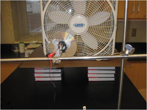

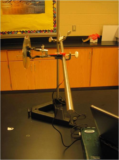

Posted: 02:26pm 25 Feb 2010
Here you have some pictures
Gaby Muino

Can you post a close up photo of the back of your generator setup.
Will check back tomorrow as late here now.
Pete.
gabymuino
Joined: 25/02/2010
Posts: 26
Posted: 07:29pm 25 Feb 2010
Mine is just the same as a standard CD player...
I just took a part an old CD player and I connected the two wires (black & red) to the voltmeter, to measure the voltage that the CD windmill generates.
Gaby Muino
