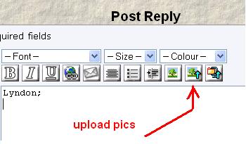

Photos would be nice and to post a photo use the button second from the right with the green arrow on top of the reply window.
If you have large size photo files you might want to shrink them first.
I do this in "Paint" open the image in paint then click "Image" .... "Resize"... I use about 50% to both horizontal and vertical ...Then OK....Save AS.. the image... I just add "small" to the previous file name...Click OK.
Now post the photo.
I find it much quicker to upload this way.
The forum will resize most photos but it is slow at doing it.
Pete.

Lyndon;
When you upload an image it will need to be in JPEG Photo format. MS.Paint, as pointed out by "DOWNWIND". is a good program for shrink and stretch.
so when you use it, click, save as, and when the window opens enter your picture name, and the second linebox down, open this drop down menu and choose JPEG. it will be saved in this format. It defaults as bitmap if you forget and will not be accepted by the server when you try to upload. Welcome aboard.
