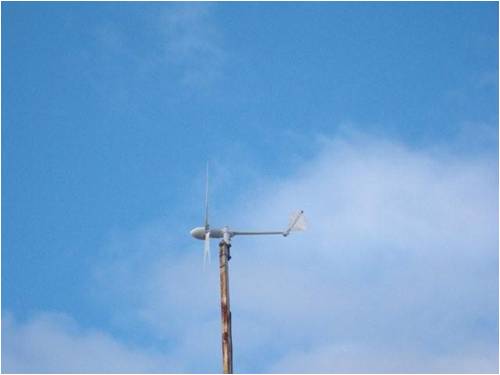

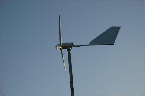

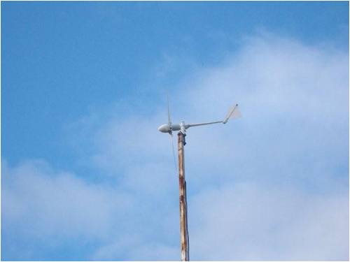

Posted: 12:47pm 01 Mar 2010

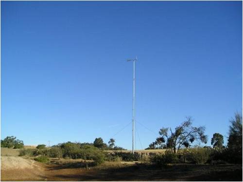

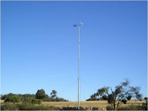

Here are two photos!

Posted: 12:56pm 01 Mar 2010
Thanks for the pics bolty
Mine is very different in the tail section. I forgot to take my camera with me on saturday but I have some pics at work so I will post them tommorrow.
Darren
PS I like your Tail.

Posted: 08:00pm 01 Mar 2010
Hi Crew,
Yes,that boom is the pivoting type,smaller machine than the 2.5Kw. It's boom is at an angle (offset) fixed. The fin blade is fitted to a 45 degree sloping axle ,the fin furling on this axle . I've never seen this before ,but if it works,and I'm sure it does, then it could be a different way of thinking for the rest of our mills. I expect there are advantages in that less reaction around the gennie end,the only movement is out at the fin.. We'll see.

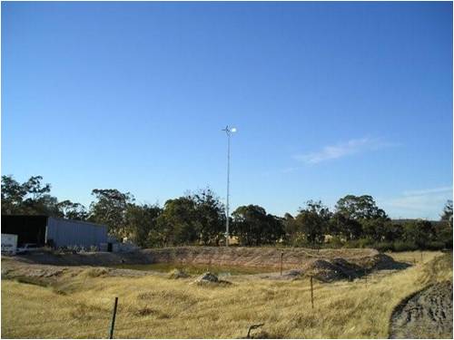

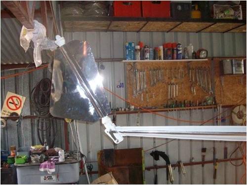

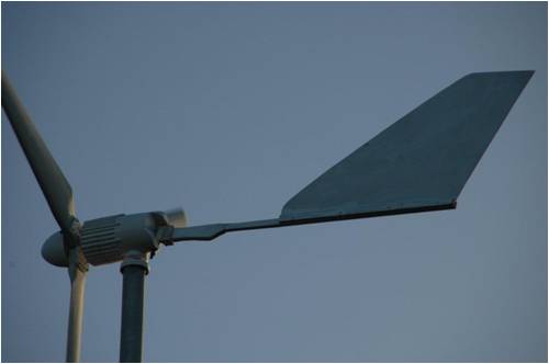

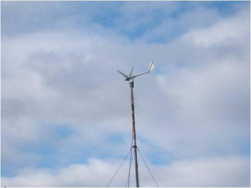

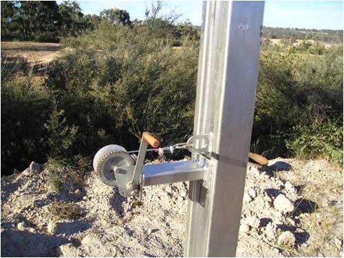

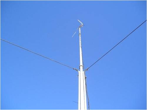

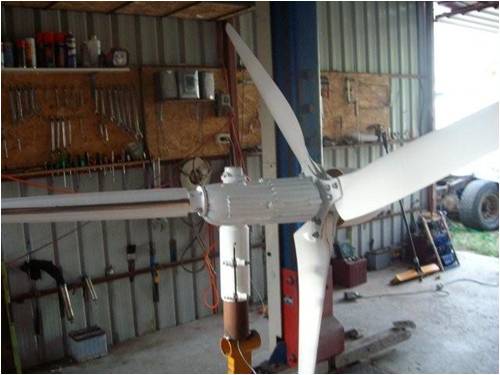

Posted: 10:40am 02 Mar 2010

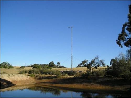

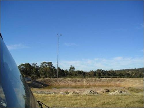

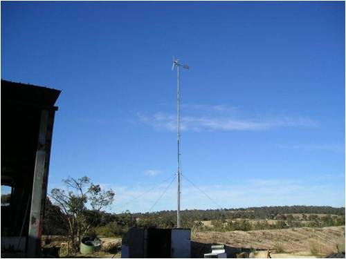

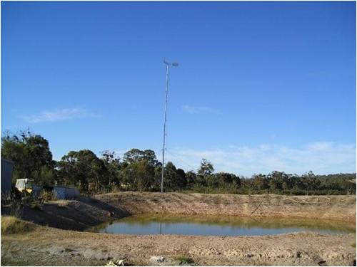

Hi guys ive acttched some pics for for you all as well as Karl

KarlJ
Joined: 19/05/2008
Posts: 1178
Posted: 11:06am 02 Mar 2010
mate that is one kick ass tower
Darren
Joined: 13/07/2008
Posts: 20
Posted: 11:49am 02 Mar 2010
Thanks Karl I built it for a F&P so i made it easy to put up and down
