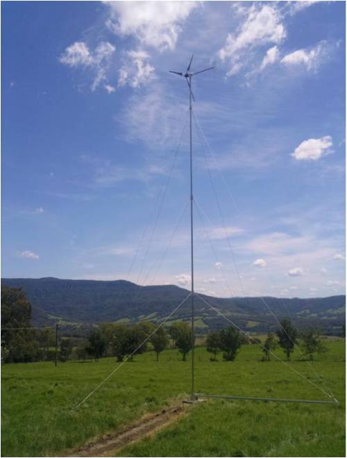

Here is a pic of a whisper 200 that was recently set up. This is on a 50 foot tower. Nice setup, with 3 sets of guys, with Gin pole. Was apparently a big job. Imported tower Kits need work, to fit pole materials available here. This is a grid connected unit, with PVE1200, and matched controller. No power production details yet.
Gordon.

So much for their easy to set up towers even at $1400 +pipe
Certainly an elegant generator and pole mount but
I was always put off by the blade extensions and output
1000W at 11.6m/s as opposed to the competition
who rate their turbines at 9-10m/s. in which case its more like 900W at (36km/hr)10m/s
AT more than twice the height of my tower but I'd hope it would make up for the extra wind required.
I'm thinking should be a really nice piece of kit at $4700+ and at 2.7m diameter, obviously catches 5.7m2 which is a full 1.3m2 less than a 3m rotor. 20%less.
They do quote 1896kw/hrs a year for an average windspeed of 5.4m/s which is 120KW/hrs lower than a SOMA rated at 10m/s but has the same diameter.
So $4700+ PVE1200 $2000+ tower and anchors $2000+
+cable $500 + installation $2000.
Id make it at about $11,200.+ depending on how the bits were sourced and install actual costs.
I think your setup is in another league Gordon.
Hell I think your F&P would give it a run for its money.
They claim output doesnt drop with furling but the graph clearly shows it does
Its great that its up and any mill is better than no mill, but to me its just inspirational.
A Phillm machine at 1/4 the cost even with the iron core drawbacks of the F&P is starting to look FANTASTIC!
In conclusion - The OZ-AX-FX and the soon to be AXFX400
should be able to easily match the price and will kill it two times over for output.
I'm hoping My dual will see it off too even with the lousy 7m hub height (20% more swept area) and wind increasing with height call it 10% more wind thus 25% more grunt available.
as you suggest time will tell.
I have a deal with dad, if it breaks 1500KW/hr in a year, we're going for an AXFX as the cost can be justified.
After all no better proof than in the pudding.
BTW of the logged data you have how much does the F&P do/annually and how much does the Axial flux do?

Gordon
Thanks for the post of the new Whisper. Nice to see an American made mill down under.
KarlJ
There is somethng to be said for going with an a factory made and factory back machine. I would think most folks (unlike us) would prefer to buy new and start cranking out watts asap.
On the flip side when I tell people that I built mine I get some big smiles and lots of questions. Most folks around here know nothing about wind mills so after I tell them what little I know makes me look good and it's lots of fun.
