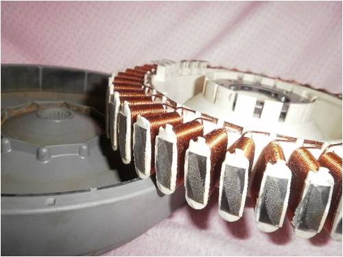

did you de-cogg like this
This shows poles twisted then high spots removed.
Should have take you about 15mins.....

For filing the stator I use an angle grinder with a flap wheel, normally I just knock off the high spots as shown in the pic or bolt the stator to the bearing block with the shaft, hang onto the shaft and use the angle grinder to true it up whilst spinning, doesnt take much and takes probably 20mins all up.

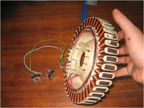

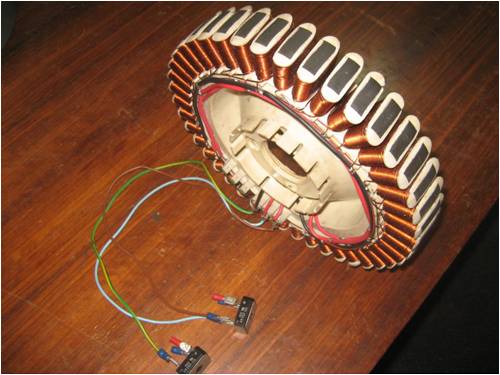

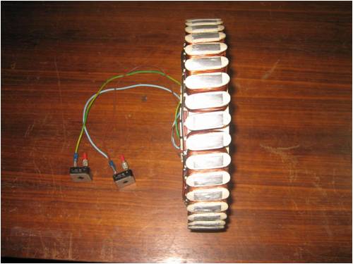

Here are the images of the stator.

dvn8;
I have never seen a modified F&P other than pictures,
The one you have pictured here appears to be short on the number of output wires, I see what looks like 6 output terminals which I would expect but no wires coming off them to the diodes.The phases may be short circuit at the
diode connection. this would surely make it difficult to spin. The 2 black wires circulating the stator is probably the pair of one phase The Red another phase, The third is
not visible here, may be at the terminal strip solderded
directly. I don't understand the bare wire connected to the diode, maybe some one can enlighten me on this.

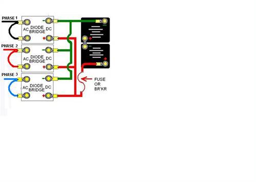

This is how I see it.if this be wrong? Let it fall. PS. You can learn about the back to back capacitors when you get some voltage showing. Hang in there you have a good start.
EDIT;
Re draw image to show terminal jumper wire on AC. Output X Y Z.
Edited by Greenbelt 2010-02-27
Posted: 08:01am 14 Feb 2010
What is the stator wired for star or delta??
What config of coils have you used.

Looks like the stock rewire for 7x2C in Star to me
Well Done!
Chopped every six coils apart and wired accordingly.
OK to share a rec across two phases.
I trust you have bolted the magnet hub on the shaft and bearings and given her a spin now the rewire is done?
