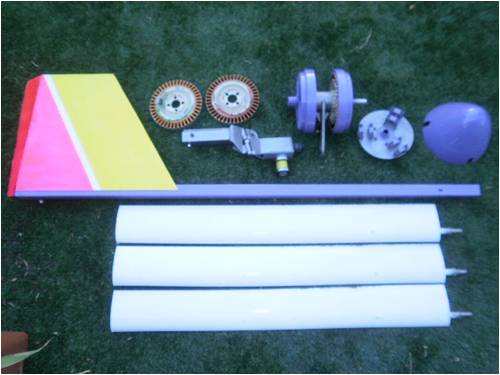

Lashed out and bought a Phillm dual after I saw the excellent blade mounting solution, been umming and arring for 6 months now (thanks Phill for putting up with me and the endless questions)
Here's some pics, I know there was some discussion over the colours people wanted from Phill, so all the bits that weren't painted, I allowed the kids to choose, looks pretty smart!
Have 2 sets of stators set aside, hoping for the two 100S (one in star and one in delta) to be good for over 1KW at 500rpm
and the two 80S wired as 7x2C (one star and one delta)
Twisted the poles on all of them and varnished them too, even painted the stator support rings!
Here's some pics for people to drool over, should be up in a month or so -waiting on the solar guy and sparkie, trench for the power and tower to go in -sorry no pics of that yet but 7m monopole tilting!
Weighs in at a hefty 43KG all up
Bugger photo doesn't do justice to the purple, looks blue in the pic!

Hi Karl,
That tail is one of a kind , the girls did a top job .
Looks like the Aluminium blades are also painted .
Hopefully all the services go in soon and we can start to see some good results

Yep, blades (and tail) in aluminium etch primer, then flat white basecoat, then gloss white topcoat, should keep them in good nick for a few years yet!
Plenty of doses of loctite, bearings to the masthead, F&P shaft to the F&P bearings, hub centre to blade mount handfull of 3/8" nylocks for the blade bolts and a handful of washers.

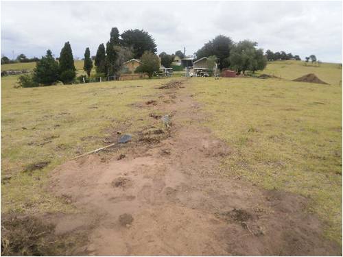

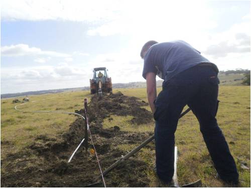

Posted: 09:27am 20 Jan 2010
Progress update

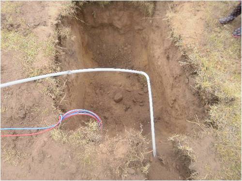

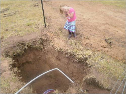

Backhoe digging the trench and us backfilling
Hole Inspector Sophie
Hole completed
View back to House

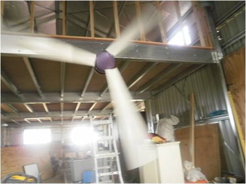

Wind turbine after balancing and final assembly
temporarily mounted on a beam in the garage.
Now for the special part -I spent some time getting the stators exactly set up so that one stator pole is in-between the other stator, result.......
with the door open and a few windows open behind it.....
The windmill would sustain about 100rpm IN THE SHED!!!!!
(no load but nonetheless pretty bloody happy with that)

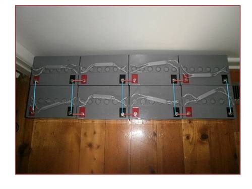

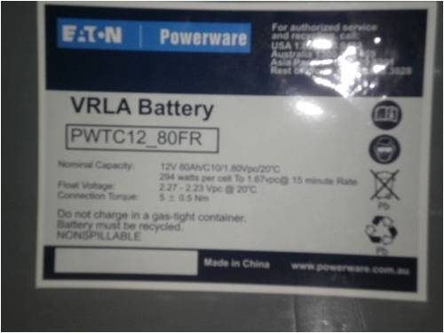

OK scored some batteries today 8x 80 AH SLAs
all virginal but a few months old paid $600.
Again amazingly enough the guy had an F&P windmmill in the backyard!!!, he had seen peak output of 600W using the 7phase into 48V -pretty good I reckon!
Question should I parallel the 2 x 48V strings or parallel each 12V battery, then series the 4 batts? like the pic

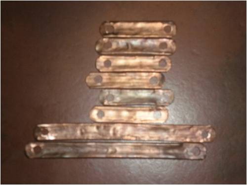

Bugger, made up links between all the batts pretty much as shown, (exception of the three blue lines in the middle as couldnt be bothered) then downloaded the instructions which say to leave a min 12mm airgap between the cells..
ah more flattening and drilling....

Hi Karl,
the links appear quite thin. Are you planning on connecting a power inverter to this, or only a GTI.
10mm copper would be good. Some, flatten 1/2" copper pipe and drill some holes each end.
thicker is better than thin.
Gordon.

Karl your work looks very neat and tidy but as Gorden said it looks light in the wiring.
The last place you want to introduce any resistance is at the battery bank.
Pete.

This was my schematic only... with powerpoint,

     Page 1 of 4
