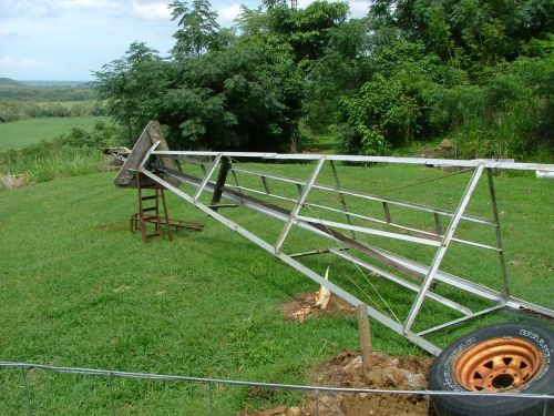

We dropped my Southern Cross windmill yesterday, literally. My neighbour Russel was over with his backhoe and we tied a chain around the mast at the 2nd cross brace down, about 4 foot down from the platform. Russel took the weight while I undid the bolts holding the tower to the concrete posts. I was a little worried the mill was top heavy, so I tied a rope to one leg and held on as Russel lifted the mill clear.
Well it was top heavy. As soon as it cleared the concrete posts it tilted over, and I couldn't hold the rope tight enough, started slipping and burning like hell so I let go. The windmill, tower and all, did a mid air flip and the turbine hit the ground.
All OK, but bent turbine. The turbines on these things are made of segments that can be separated, and it only bent 2 segments back, so I can easily fix it with a vice and hammer.

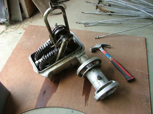

I took the tail and turbine apart, and slid the nacelle off the tower. I enjoy working on these old mills, its all split pins, 1/2 inch nuts and gear oil everywhere, like working on a old car.

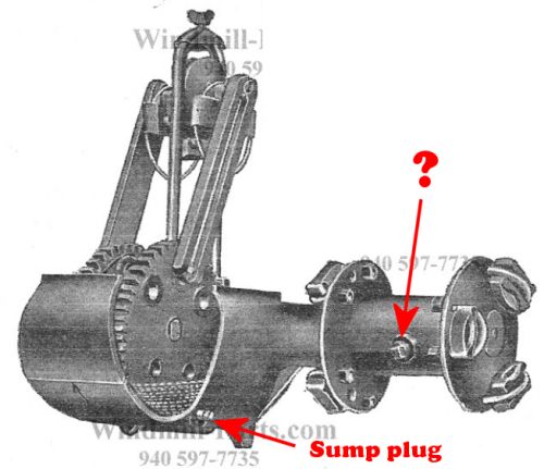

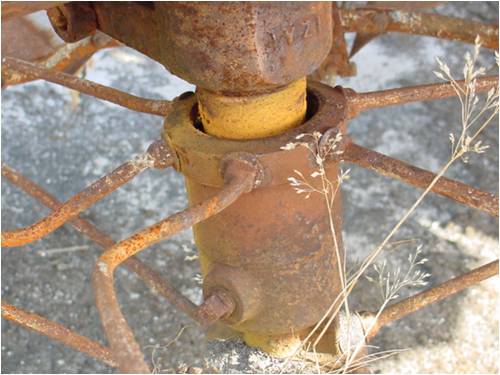

I do have a question though, there is a bung on the side of the turbine hub, and I dont know what its there for. The graphic below shows it.
This isnt the sump bung, but its the same size, on the side of the hub. Would anyone know what its for and if I'm supposed to do any maintenance with it?

Darn good question. When I built the new bearing on mine (used aluminium not tin) I pondered this for a while. From memory, it lines up with the oil escape hole in the bearing outer journal.
These things are cunningly built to be maintenance free for the most part, like those two rings at the top that oil the upper journals each pump cycle... pure genius.
However, my best guess was this:
When the thing rotates, the oil is picked up by the primary gears and lifted onto the spring around the front shaft . It runs down the spring with help of the rotation, and delivers the oil to the shaft/journal interface. Here it seeps down the shaft and exits at the front and through the hole at the top of the nose casting and the journal end.
The nose casting is about where that bung is. The excess oil leaves the nose and fills up the hollow inside the hub. There is a ridge that keeps a fair bit of oil in the hub, maybe to protect journal at the nose end, I'm not sure.
When it rains, small amount of water may run down the casting, and along the bearing nose casting until it drops into this oil reservoir. It will then become a water /oil reservoir with access to the nose end. I suspect the bung is to drain the excess oil and water periodically... but just a guess. It would allow you to know how much oil is getting through as well I suppose.
The fact that mine lines up with the oil hole in the nose may be that at installation you could prime the bearing, but this seems obscure too.

I am assuming this is a Southern Cross, if not then dont rely on the statement below.
It's the top level for the oil, you wont have a dip stick to check the oil level, this is the dip stick you undo that bung and add oil through the oil filler opening untill it starts to dribble through the hole, then replace the bung.
You will notice from the pic that the bung with the ? is just below the centre point of the cogs to the left, this ensures that the turbine shaft & the pump cogging are lubricated.
The same oiling method is used for outboard motor legs you undo the bottom bung & screw the oil can into the bung thread, you then undo the top bung & push oil in untill oil seeps out of the top bung hole.
BarryEdited by Barry T Coles 2010-01-06

Gizmo;
It is likely the proper level of the lubricant in the hub.
If this hub is isolated from the crank gears which it appears to be. I do not think this would be a fill plug as this much cold oil would be highly inefficient.
When adding or changing the fluid, the hub should be level ,when oil runs out this is full.

No Greenbelt, oil measure is a simple line in the cast. The weather cover comes off, and exposes the open sump completely.... to fill, just tip er in.
This bung is in the rotating hub itself. Open to the air on the backside with a 1/4"gap all around. It has no path to the sump, except through the spindle shaft/journal interface (maybe 1-2 thousandth of an inch). Oil will seep out of the journal end (means the oiler is working) very slowly if the journal is good, and not so slowly if there is plenty of wear.
The idea is that every so often, you refill the oil sump, and it uses it up via the journal. If you forget, the oil runs out and the bearing journal suffers.

I did remove the plug when I first bought the windmill, couldn't see much in there, so poured in some oil just in case and closed it up. I figure you cant have too much oil, it will just leak out if there's too much.
Oz's explaination makes sense. Whenever I top up the oil, remove the bung and turn the turbine so it faces down. Any old oil and water in there will drain away, and it will fill with clean oil that seeps past the bearings. I wouldnt hurt to pour in a cap full of oil either.

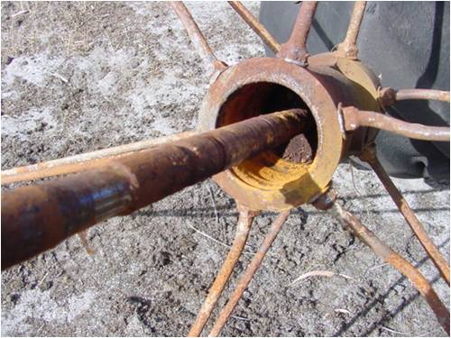

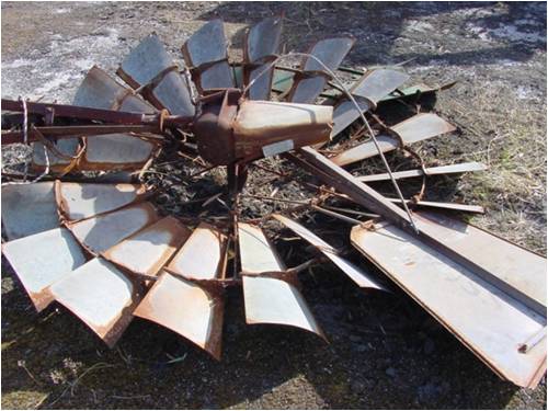

I went up the scrub and found this:
It was not well. Fell over in a storm and the owner dumped it here.

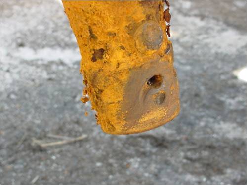

Here is the clearance from the hub to the casting. There is no way a grease fitting of any kind would be useful here. That theory is out I think.:
Here is the offending bung. It is straight through the hub to the big cavity. Note, the part of the casting with the bung, does not hold the shaft. That thinner last 2" or so is the only part that contacts the shaft steel. It has no grub screws, pins or any other mechanism to lock the shaft in. It is multi ton press fit ... and thats it. Any other system would not work, as there is not enough shaft to sensibly stabilize the hub to shaft if the fit was not very very very tight.

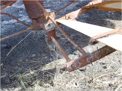

For those curious, this is how the spokes are set up:
Here is the inner of the hub. 80% of it is hollowed out. You can see the ribs there. These keep the oil from the shaft rotating around the inside for reasons unknown. I suppose it does keep oil around which is good.
This next shot is the clincher. Notice the teardrop depression in the cast coming from the hole. This directs the oil away. It is this hole where the oil from the journal exits, so it leaves from the highest point, so the shaft should be floating in the oil in the journal.
It weeps out this hole, and runs down into the hub ribs.
So I think that about covers it. That bung does no more than empty whatever water and oil has accumulated since the last service.

Posted: 02:18am 06 Jan 2010
Oz, Is that a southern cross mill?????
I didnt think the SC had spokes like that or a mill cap shaped like that.
It looks more like a colac mill or Varco to me, but it been a long time and not sure.
Most of the mills in the southern area were Varco, Metters, or Colac and the SC was more to the north of Aust. with only a few in the southern area.

Yep, a SC mill. ZA1 (you can see it on the mill casting second picture. )
The spokes are supposed to be straight, not like the picture.... this one has taken a fall and rough handling from a tractor. I admit they look like a mangle wheel arrangement at the moment, but they will straighten out ok.
I will recover from the engagement... Mr ant will not.
