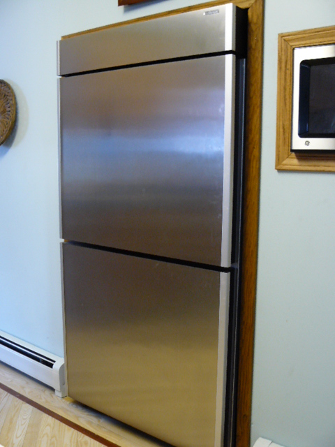

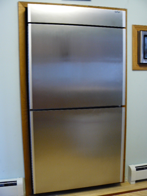

I understand that your fridge (annually) will consume more watts then any other appliance in your home.
I purchased a Sun Frost several years ago. Made in the U.S.
It has two very efficient compressors that along with the condenser are mounted on top of the unit to dissipate heat.
One compressor for the freezer and one for the cooler area.
My original fridge consumed 200 watts the Sun Frost uses 80 watts. They come in different voltages.
One of my goals was to get my fridge off grid at the present time my fridge is off grid about 98% of the year. Not cheap but it works for me.
I am sure the shipping cost for you mates down under would be VERY HIGH.
www.sunfrost.com/
