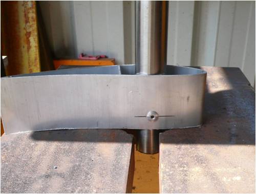

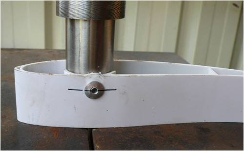

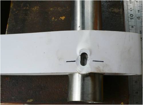

To give myself and others a guide I load tested both types of blade materials which are used in making this airfoil using the common mount method of rivets and bolts , the small pieces were attached to a 25.4mm piece of s/s tube and set up in my press , I fitted a lower pressure gauge to allow for a more accurate pressure reading at lower pressures .

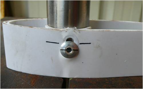

First test 2 x 3/16 rivets in PVC blade piece
Set up in press with marker line to see first movement.
Rivets started cutting through at approx 150kg - 200kg ( Temp was 30 deg C )
at 250kg the rivet let go from what appeared to be a build up of material under the head and poped it off.

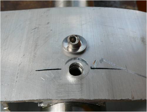

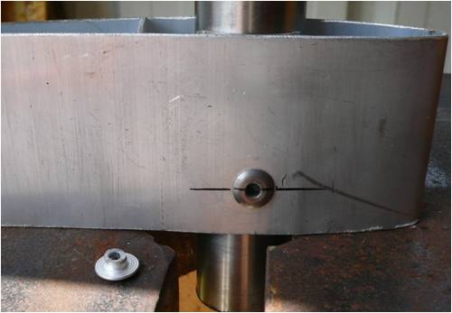

Test2 Aluminium 3/16" rivets with aluminium blade piece , I took it to 500kg then 600kg at that point it sheered

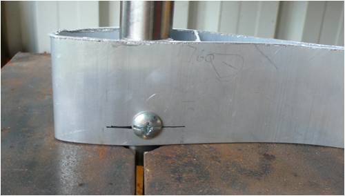

Test 3 Changed to rivets I normaly use ( I think they are s/s as they are not magnetic ) 3/16" . Al rivet frm test 2 shown
Test 3 - 750 kg no movement , 900kg sheered after about 1mm of movement .

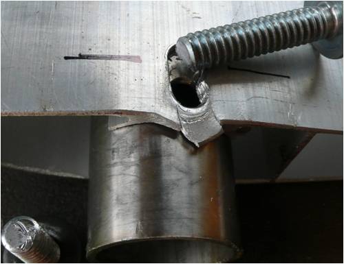

Test 4 - 1/4" bolt low tensile
500 kg no movement , 1000kg ( 1Ton ) no movement , 1250Kg moveing and cuting aluminium , kept going at 1250kg then bolt sheared
As I have already seen movement in the pvc 3.150 set with 6 rivets of about 1-2mm after reaching 750rpm I would ascertain that at that speed the centrifugal force on the pvc blade was 450kg to 600kg to allow the rivets to start cutting through the blade , as I have not added extra rivets and there is now a build up in front of the rivet I would say that it will take 750kg + and higher rpms to get further movement or softing of the blade material due to the heat of summer .

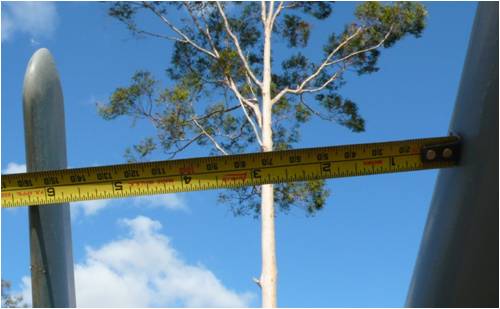

Below is a pic of how close I run my blades to the pole 150mm on tower 2 and 200mm on tower

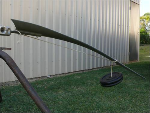

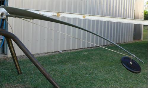

The blades shown below are my old ABS blades which have been through quite a bit , origionaly they were 3.2 m but after hitting the deck at 780rpm and being a bit damaged I cut the root section of to make 2.8m . At 3.2 m they were very flexable and still are at 2.8 , not once ever have thy looked like they were going to hit the tower . As you can see from the 2 pics below the first with a 5kg weight at the blade tip and the second with 10 kg approx 1/ 3 in from the blade tip if gyroscopic force or yawing force at the end of the blade reached this force , they would be history .At high speed in high wind I have watched these flexing but the tips don't get any where near the tower , so how much of these forces which get labled as massive and extreme are really there when blades are in full flight , obviously not this much , or does centrifugal force come into counterbalance the other.
5kg at tip
10Kg approx 1/3 in from tip

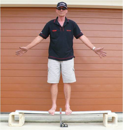

The two pics below are of the 1.5m Aluminium blade , I decided to see how much these are good for in a beam strength deflection type of test .
About 20mm deflection with 78kg in the middle area of 200mm either side of centre and supported 50mm in from each end and no internal tube
There was no permanant bend left in the blade .
With all the infomation I have through testing and observation has left a few questions in my mind with regards to how much support these blades require , as you can see from the test of me standing in the middle section and from the sheer tests

Could it be that the plastic blades started to fail because the pop rivets were not in full contact with the material? I.e there is a small gap under the head around the shaft of the rivet which allows for compressive forces to spread the plastic perpendicularly to the shaft.
Perhaps using an aluminium plate over the blades (or a smidgin of gap filling epoxy resin that could have the excess cleaned off easily) would eliminate this?
Small details perhaps, but any movement around the rivets could turn static loading into (minimal) impact loading when in operation.

FYI Phill
pic
3x the diameter of the rivet or bolt is the aviation industry standard minimum distance to the edge, which is why you have some tearing of the material there
4x the diameter in composite material (like PVC)
not knocking the test, still clearly shows the intent but for the mill, give them 3D from the edge min.
