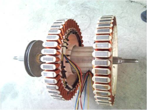

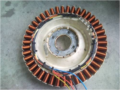

Well I started making this.. my first mill about 6 months ago, its been a slow process having had a few holdups along the way... mainly family and work! . Originally I was it was only going to be a single f&p , but after viewing projects from other members it seemed to make more sense to go for the dual. I was trying to pick out the best ideas from the forun with a few of my own chucked in . I first started by cutting the shaft and bearings from a f&p and machining the nylon casing into a cylindrical shape

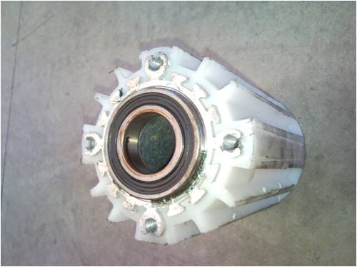

I then machined an old starter motor body(just the right size) and snuggly press fitted the bearing housing into it.

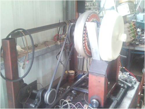

for testing purposes I added a pulley and mounted it into my test bench at work, just to see how much output i could get out of a dual setup. . they are both star wound 2x7c

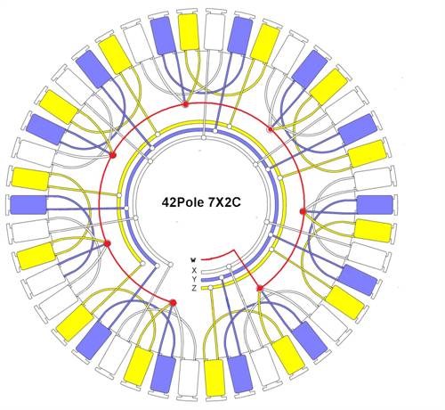

I also connected all of the 7 star points together for a slight increase in output and fed them in to an additional rectifier.
have seen this idea work on motor vehicles for the last 10 years or so with and increase output of approx 10%. so i thought id give it a go
Connected 4 12v car batteries in line and got a readout of 13 amps @65 volts = 845W. I...was...happy. It had more to offer but the belts were slipping on my test bench, but would have been interseting to see just how much it can actually put out. Next was to mount the two stators on to the shaft.the first one (back side) in the usual manner ....just screw it on!! .The front rotor I machined so it snuggly fitted onto the shaft. similar to Phills dual setup.

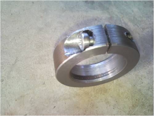

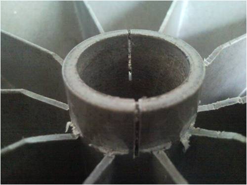

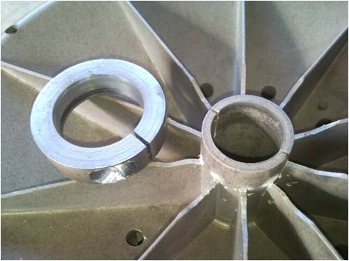

I then cut away some of the webbing
and fitted a ring with a tightening screw to further help hold the rotor onto the shaft.

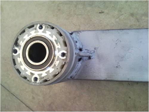

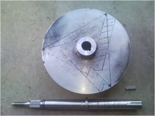

cut the spline of the other end , tapped a 12mm hole and keyed the shaft to fit into my hub

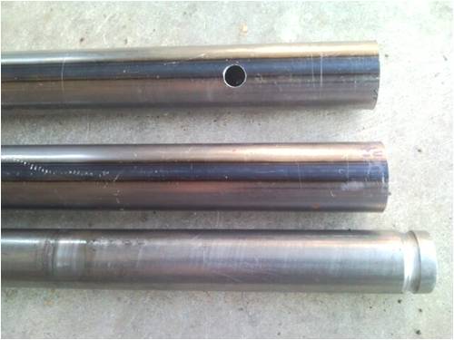

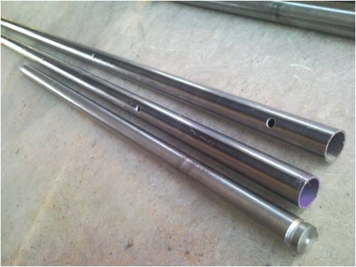

Then tapered the ends of the 22mm dia, 680 mm long solid bar as suggested. The other end I machined a groove for the ubolt to locate to prevent the blade from coming adrift. Drilled 4 holes for plug welding into the 25 mm, 1500mm long od tube, the last hole being 100mm from the end of the solid bar. .

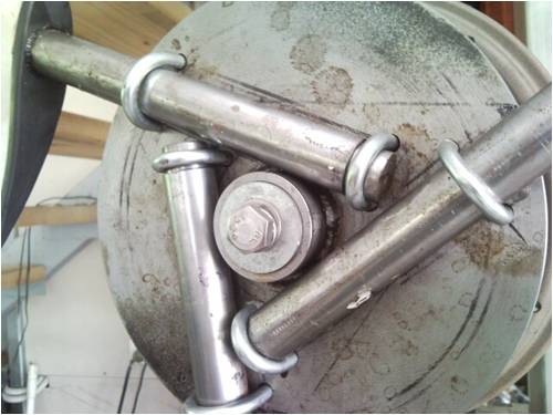

Inserted the round bar into the exhaust tube and mounted all 3 on to the hub, each with two 8 mm u bolts
This being my first mill, there probably are flaws in my design, so any suggestions of improvements would more than be welcome. more to come!

dont quite understand how the joining of the star points will work, schematic perhaps?

  gpalterpower said
Im not too sure how joining the star point together works either, but i know from experience it does. Im an auto sparkie for the last 30 years (thats too long)and this concept has been in conventional car altenators for about 10 years or so. take your average vt commodore . bosch brought out 2 alternators for this model, one 90 and 100 AMP . the only difference is a 6 diode plate for the 90 and an 8 diode plate for the 100A , in which the star is connected to the additional 2 diodes.hope this helps.
marcus
Would you have a diagram to show how the 2 extra diodes are connected? I'm curious and would like to 'borrow' that idea.

Hi Tinker,
The centre connection of the series diodes connects the star point to the + & - battery rails. Looks on paper like just an extra half bridge.
I imagine that at higher power levels, the star point voltage has an AC component that is clamped by the diodes, with resulting extra current to the loading.
This probably works best with the highly nonlinear loading that is a battery and rectifiers.
Gordon.

Klaus, Marcus,
I think Gordon is on the right track with this. The diodes seem to be there to pick up the pieces from the poor loading that battery charging does to the waveform. Some call it crest factor, others power factor.
Either name refers to using only the tops of the waveform... ie when Vin is greater than batt voltage, the diodes conduct, which leaves a fair proportion of the waveform unused (the bottom parts less than batt voltage)
This basically turns the sine wave into a squarish wave... the top will be flat (batt voltage). This produces harmonics (in fact a good deal of high frequency noise)
This is usually lost to us..... but if you put a few diodes as you have suggested, it allows you to pick up the high frequency noise and convert it to useful output.
Note.... you will need a high voltage, ultra high frequency diode I suspect.... perhaps as high as 600v@3A.... depending on the wiring scheme in the stator...( but 200v as a minimum I would guess)
It can see the high frequency noise/voltage > batt voltage in the any of the phase coils and directs that to the batteries.... where the slow diodes would not.
At least, that's how i think it works ... any counter comment welcome.

we've seen this before, someone called it an "open delta" arrangement.
Perhaps we should call this open star?
http://www.thebackshed.com/windmill/forum1/forum_posts.asp?T ID=558&KW=open+delta
'tules would the "normal" square type rectifiers do the job, I dont understand why the frequency here would be any different than the other 3 phases.
when one of the admin guys is around perhapos they could add this to the F&P rewire page....
Phill this might get you over the hump that is 750W for the f&p dual, turn it into a 825W machine!
I'm thinking putting CAPS on this end would be a looser as you would be doing it to both ends....
More testing for those with mills and doublers!
KarlEdited by KarlJ 2009-12-15

  gpalterpower said
marcus
Hi Marcus
Excuse my ignorance with power generation, 3 phase grid, single phase grid & DC I understand.
Can I assume from your picture that the red wire W is the neutral & the others XYZ are the phases as in 3 phase grid?
Barry

Posted: 11:40am 15 Dec 2009
I think you're right Barry, the red wire is the centre point of the star which would be the neutral.
Hence I was at a loss as to how you would get any power from the neutral point.
I put it in to the too hard basket as I'm running (2x) 15A extension leads down the mill, and dont have any spare wires, nor do I hop to understand what this might do to the cap setup.
He can hunt for the extra 10% and i'll get the other 50% from the expensive CAP solution
