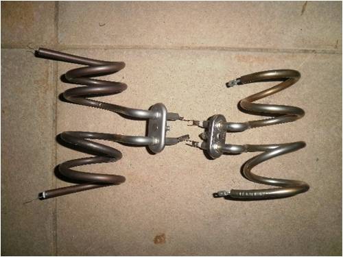

check out the article from the homepage on encapsulated resistors.
They are free (used dishwashers is my preferred)
Cut to length as required for the dump Volts x Volts / Ohms = Watts the resistor will use.
Easy unless you are immersing it in water then will need some more effort to keep water out of where is shouldnt be.

Posted: 03:40pm 09 Dec 2009
You can bend an element and silver solder it into a 2" ball plug with 2 holes drilled in it for the element to pass through.
If you can find a long element with a suitable bend already in it. than you could shorten it up to suit your wattage requirements.
It will make little difference if it is out of a stove, dishwasher urn or what ever but i do think the dishwasher and likes have a slightly heavier outer casing.
