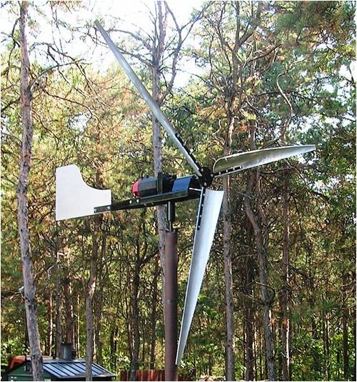

Pic1 - 8" sched40 PVC blades, quartered.
I didn't round the leading edges. Will probably do that next.

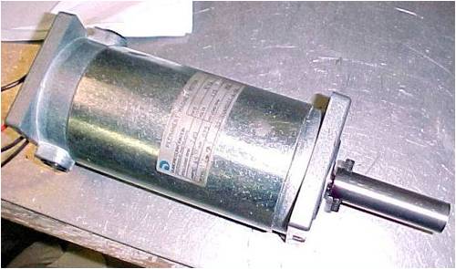

Pic2 - Motor: 130vdc, PM.
Being direct drive, I may be expecting more RPMs than what is possible.

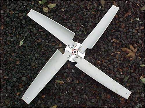

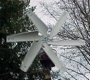

Pic3- The mill with the 6-blade configuration.

Hi Rich. It would be good to know what rpm that 130 volts is rated at. Should be printed on the motor. That will give you a decent idea what rpm your rotor needs to turn at in order to hit your charging voltage (probably 13.5 volts). Once you know this you can size the blades correctly. I think the best trend would be to go with a smaller diameter, thin bladed, 3 blade setup.

It would seem that your generator was designed to operate (as a motor?) at a much faster speed than your mill can drive it. One clue to this is its diameter, which looks relatively small from your pics. I also note that you are only seeing it produce about 4-5 V when driven by your mill (presumably in low winds).
