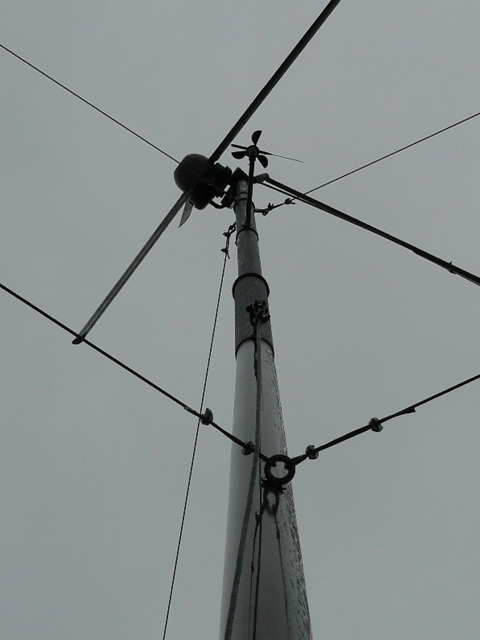

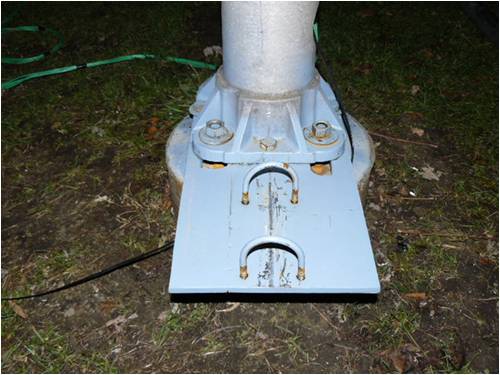

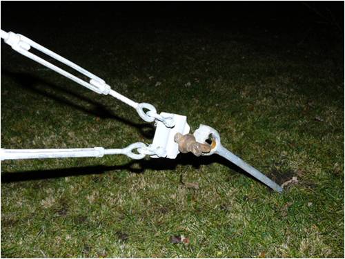

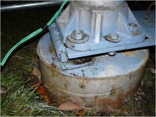

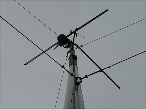

JimBo911
Joined: 26/03/2009
Posts: 262
Posted: 01:37am 18 Nov 2009
imsmooth
A few pictures of my present setup.
Screw in auger, tower hinge plate with gin pole u bolts.
Hey the neo,s are working great. 60 series F&P 700 watts.
Thanks again.
GWatPE
Joined: 01/09/2006
Posts: 2127
Posted: 04:03am 18 Nov 2009
Hi Jim,
the hinged base with detatchable gin pole should work well.
I hope you intend to fully wire all the D shackles and the turn buckles. Post a picture with them all wired, and I will post a positive comment. I have seem the results of a pin working loose on a D shackle, and a separate instance with a turnbuckle unwinding. Not pretty.
Mechanical devices need periodic checking and maintenance.

JimBo911
Joined: 26/03/2009
Posts: 262
Posted: 02:36pm 18 Nov 2009
Gordon
It took me a long time to get that dam hinge plate to work. It pivots on an fixed ark with no other movement getting the bolts to line up wasn't easy. The mounting bolts farthest away from the hinge worked OK because the holes in the tower came down on them with less of an ark but the closer ones gave me a hard time. I got the idea of a hinge plate from the till up tower kit you can buy from South West Wind they sell it with there SkyStream 3.7 The reason I like the hinge plate is because the plate will only let the tower till in one direction. (North South etc) Thinking that this would make tilling a lot safer and easier.
All of the 5/16 shackles do have cotter pins in them, the one and only 5/8 shackle does not I WILL CHANGE THAT. Never thought of the turn buckles working lose, will take your advice and modify them accordingly.
imsmooth
Yeah I am glad that I went with your neo's 700 watts peak (so far) definitely surprised me. Together with one of Gordons caps/doubler it seems to be working well. It did involve more work but I am now reaping the rewards of your design. Other forum members have had difficulty stopping there F&P mills with dynamic braking. My mill has shut down each and very time and quickly I might add.
My tower believe it or not starts out with a 30' used, aluminum, tapered, flag pole. I got REAL lucky and sourced it from a friend for free. Just so happens that a 4" inch id pipe (4" galvanized imc electrical conduit) slips over the top the alum flag pole and goes down about 3 feet with the flag pole being tapered it fits nicely and is centered perfectly, I had to machine a spacing bushing (PVC) to take up the clearance between the pole and pipe at the top of the alm pole. The 4" imc conduit extends two feet above the flag pole, total length of the the 4" conduit is 5'. From there I used a 4" to 3" galvanized reducing coupling ($60.00 ouch) to a 10 foot length of 3" imc galvanized conduit. Then again from the 3" to 2" galvanized water pipe. The 2" pipe is 5' long and gives me more blade to tower clearance. Cable specs are 1/4 inch dia , 7*7 strand, 1220 lbs working load, 1880 lbs breaking. The mill sits up 47' with the blade tips another 4'6". I have a 50' height ordinance over here. Truth be told at 47' tilling it up and down has some scary moments not sure if I would care to till anything taller.
I built a small room addition on my house several years ago the tower is approximately 35' from the addition if it did come down in the direction of my addition it would hit. My neighbor applied for a height variance with the county to get a permit for his mill, the county insisted that the tower have a fall zone and be fenced in.
Karl
Yup the neo's were expensive but I feel well worth the extra work and expense. (now that it works) With an 36 finger F&P stator there is no clogging even with the neo's. As I was placing (building) the neo's in the rotor I temporarily installed the stator with some but not all of the magnets, I couldn't turn the rotor without using a pair of channel locks but when all magnets where installed there was no clogging. Testing on my lath proved that the neo's at least doubled the out put over the ceramic magnets. Turns out now that my mill is flying wind the (of course) is much stronger than my lath and the power out put is better than expected.
Hey I still have my finger crossed the wind is a mighty flicked thing. Some luck and lot of help from the forum members is what's made this happen.
SparWeb
Joined: 17/04/2008
Posts: 196
Posted: 04:03pm 18 Nov 2009
Jimbo,
I love the tower pictures. Great examples of how to do this stuff and learning from the pro's.
[quote]1/4 inch dia , 7*7 strand, 1220 lbs working load, 1880 lbs breaking[/quote]
1/4" cable usually has a breaking load of 5000-7000 pounds, expecially the better grades like aircraft 7x19. The stuff I have even has a Mil-Spec on the label. If your wire rope really came with those numbers, and that's not a typo, I'd be very worried.
Like me, you've found that 40-50 feet is about the tallest tower that an amateur can build and handle, and even that pushes the comfort zone.
I remember a comment either from Dan B. or Hugh P. that the tower hinge should have a fair bit of "slop" and that's why they like pipe turning around a pipe where there's about 1/8" clearance between the tubes and lots of area to weld the joint.
Have you read Paul Gipe's book? Lots of tower info.
Imsmooth: If you can read Timoshenko and run the column buckling numbers, but you still don't understand tower loads, you just haven't done enough work yet. Sorry for the prickly answer - not trying to flame. Kind of a mixed message between the question you ask and the comments you give afterward.
