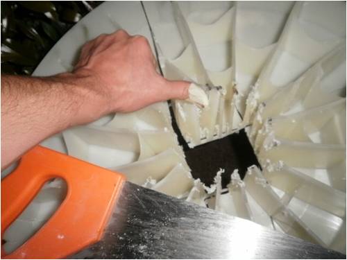

Guys I noticed on the homepage dismantling of the machine doesnt cover removing the bearing block.
the NZ boys tell me the chainsaw is not a good idea and a hacksaw doesnt have the throat to deal with whats left if an angle grinder is used but a plain wood saw cut through it like butter.
Obviously fillm is using this bearing block and now its proven and cheap may want to add this as like others, I threw it away considering it was too hard and I wouldnt need it.
All up 5 mins.... can even be done on the nature strip as previous owner looks on in horror!
still less obtrusive than a chainsaw being used to carve up their old machine.
band aid on the thumb is unrelated!

I use an electric chain saw. Some of the strengthening "spars" snap and crack but I make sure that I cut far enough away from the core so as not to damage the plastic. I tried a hole saw and hand saw, too slow. I tried a sabre saw too, but for sheer speed the chain saw was best. It just has a problem with plastic swarf so broom is also needed.

The handsaw method works a treat. When the plastic bearing block is cut out, you can use an electric planer to clean it up to a nice smooth and straight finish on each side. The planer seems to cut the plastic easier than wood.
