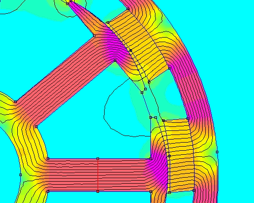

For the salient pole machines (F&P) it is opposite. For an axial, the magnet over the center of the coil is EMF min, for the F&P, the magnet over the top of the pole tooth (center of coil?) is EMF max. Stop the display with a black magnet centered over a coil center (ie tooth for F&P). The other blacks are over the gaps between pole teeth... EMF min The Grey magnets are all at various positions above pole teeth in this case, and provide the return path.... like this :
Rodney
