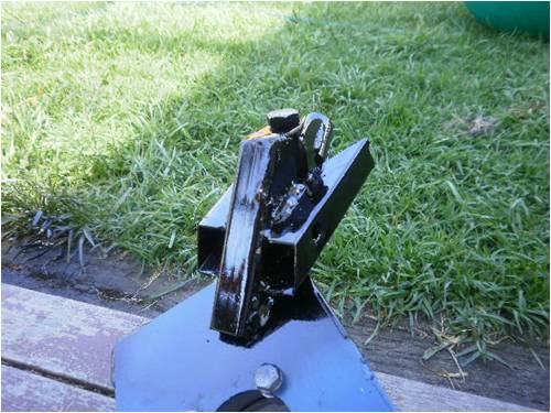

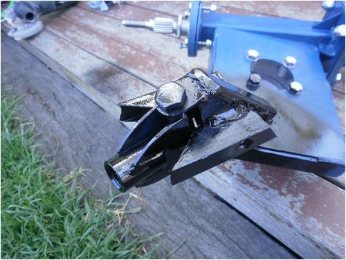

Mods to the "weldment" for tail stops. Cut off some chair legs of an old chair and although I got my mate to plug weld the tube for the blades he insisted I learn to weld on this bit hence a bit rough but probably not going anywhere.
Dad is enthusiastic and theory now is to use the PVE 1200 with the 1KW of solar and add the turbine via the battery bank, that way not out another $2K+ for another inverter and the power going to good use.
Hopefully the sun is not shining too much

Poss
Joined: 27/09/2009
Posts: 30
Posted: 11:14pm 31 Oct 2009
Karl it is a good thing that you are learning how to weld as it is a very handy skill, but I think you have gone overboard with those tail stops by looking at the pics.I'm no expert on mills but I don't think that your mill will be able to furl. I think you have got the shaft in back to front through the weldment too. I have mine set up with the stator on and the tail clears fine with no mods... By the way did you get that thrust bearing from that company I told you about...Poss
A brave man may not live for long, but a careful man does not live at all.
