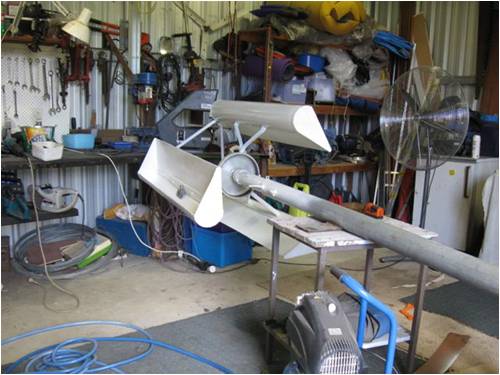

I have been thinking about current control for a small lenz2/fp mill
What I would like to do is control the current available to the battery according to rpm of the mill
I was thinking of using a scr based circuit with a hall effect for rpm info
The reason for my interest is that I would sooner charge at 24v/ .5 amp (for an example) in low wind than to have the back emf of the fp stall the mill
Once the rpm is up then lift the current
Can someone point out any major flaws on the thought or any comment, suggestions?
These are the wings at the moment, but they are too heavy so I am going to redo them and upscale a little
cheers
Tinker

Posted: 11:47pm 07 Oct 2009
Hi Tinker
Of course I have spun it up with the fan, how could I not?
It is however in that position to balance the blades
I am only concerned with the weight on the bearings
If the battery is low enough to draw current the mill cannot produce in light wind, then I would imagine it will stall the rotation
The intention is to limit the current draw on the windings depending on rpm
I don't really care if it only charges at 50ma in light winds, every bit helps and small current is better than no current
This idea came from my fp pedal machine
Put 300w lamp on and it,s a battle to get going
Put 60w lamp on and it's much easier
The idea may well be flawed, but I can't see it at this stage, hence my post
cheers

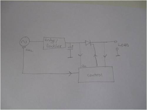

Posted: 01:23am 08 Oct 2009
This is where my head is at

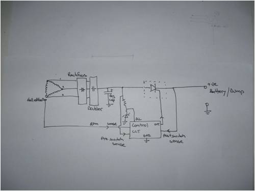

Posted: 05:54am 08 Oct 2009
In the simplest instance and given this is a VAWT, You could simply add 6 series caps, of approx 470uF and 300VDC in a back to back arrangement. This will take the load OFF the alternator and allow the windmill to spin up. The power output will be proportional to RPM.
The cct you post is hard to read, but you will need 1 per phase with an SCR. I think this will only provide half wave rectification as well.
Gordon.

turnymf
Joined: 04/10/2008
Posts: 84
Posted: 08:11am 08 Oct 2009
Thanks fellas
I hope this picture makes it clearer (my drawing sucks but it's better than what I can do with paint),
it is a block diagram and a roughy at that
The rail is dc before hitting the switch(scr in the cct)
I would imagine that the trigger would pulse which would pulses the output
What I want to do is to softly apply the load/magnetic brake (so to speak) until higher rpm is achieved by the wings
Thanks for any input
GWatPE
Joined: 01/09/2006
Posts: 2127
Posted: 08:38am 08 Oct 2009
The SCR won't turn OFF in this arrangement, until the current drops to zero, ie windmill stops.
Gordon.
become more energy aware
turnymf
Joined: 04/10/2008
Posts: 84
Posted: 09:31am 08 Oct 2009
True
Triac or gto scr then maybe
Probably even get away with a good old 2n3055

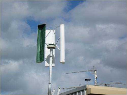

Howdy fellas
I have finally got my lenz2 up
It's a 80 series(stator pole twist) original wiring in star with the 3 phase run down the pole
Only light winds here to day
The lenz got up to about 60 or so rpm going by the 'one one thousand, two one thousand, three one.....method
The 3 phase is going into a bridge in the normal manner then the dc rail is sitting on a 6800uf 250v electro with a dvm and a couple of lamps(12v+250v)close by but not connected
I did notice that whenever it spun it would ,of course, show volts at the cap that climbed with the rpm
The max volts I saw was about 60 (cap only)at the max rpm I have seen to date
At about 50v
I can apply the 12v 50w lamp to the cap and crackle crackle, bright light then dvm shows 0v
I can apply 240v 60w lamp and the elements burn orange and the volt drop is much slower the with the 12v one
My first little bit of wind power, hip hip
I know there is a miss match of volts and this is proof of some power
The mill went start/stop all day and was a little noisy at certain rpms
Appyling a lamp load reduced rpm to near a stall but not having a steady breeze and not much of that it wasn't a surprise
I would expect that some sort of charge could be gathered on such days by having only the cap as a load and pulsing the load on and off it according to it's charge state and/or rpm
This would allow the rpm to be at it's max more on soft days
I know I am talking about low power but every little bit helps
I understand cutin now, thanks
If I was to apply a battery load today, with the setup so undeveloped and all, the mill would have remained still, staggered a little once in a while perhaps, but still
Heres a pix of it
Cheers for reading and go FORD at Bathurst
Tinker
Joined: 07/11/2007
Posts: 1904
Posted: 03:02pm 10 Oct 2009
Congratulations on getting the Lenz2 running.
I'm not sure you quite understand the "cutin" part yet. It *is* related to the voltage your wind generator has to produce to be able to charge a battery.
So your last paragraph makes no sense.
Please do try it with a battery connected. You need no capacitor, just 2 bridge rectifiers wired up to accept 3 phase AC. Your battery will limit the generator voltage to the battery terminal voltage - disregard what you measured with your lamp load.
With that generator and a decent (car size) battery you have no problem overcharging it unless you have a gale for hours on end.
Connect an Amp meter in series in the lead from the battery to the rectifier (polarity is important unless the meter is digital in which case it may read negative) and see what charging current you get. That is the only real way to test your generator, flickering lamps are not ideal at all - their resistance (load) changes drastically as the element heats up.
When your battery gets fully charged (13.5 - 14V at the terminals) connect a load to it to give your generator some work without overcharging the battery.
Do read up on the part where it says that wind generators should always have a load connected to avoid runaway in high winds.
