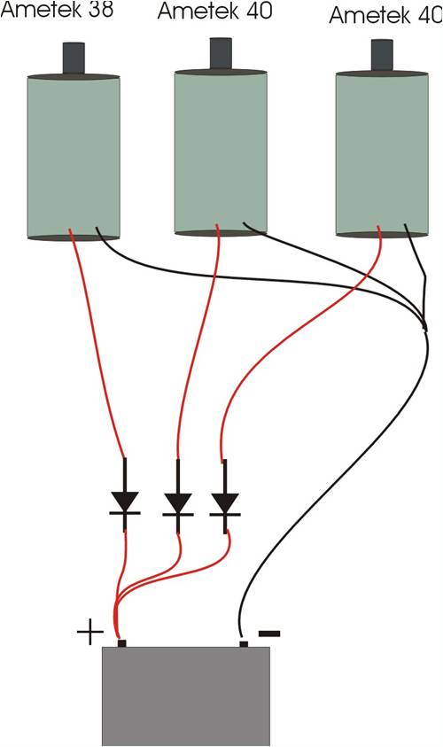

good day all,

Hi,
You CAN wire it like that, but it will not work
What you need to do, is connect all the negative leads directly to battery, and connect the positive leads like you have pictured. So that the positile leads are isolated from the battery by the rectifier diodes.

Faroun;
Janne has instructed you correctly.
this diode set up is 3 phase all circuits are independent
and if the diodes are not blown out (Defective) then there will be no short circuit. the output from the diode bridge
that is normally the big post on the alt'ntr hooks to the +
battery terminal.
Good luck with your project.
