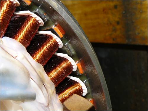

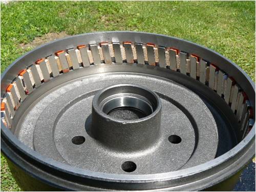

Ok guys just thought I would keep you informed. I have finished installing my neo's in the drum rotor. (See photos)

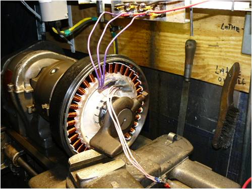

I used fiberglass resin to keep them in place. Testing on my 13" South Bend Heavy 10 has proved fruitless from lack of power. The ceramic magnet rotor posed no problem for my lathe but the neo's put one hell of a load on the machine hummmmm I guess that's a good thing.
I feel confident that electronic braking with the neo's should work very well. Wondering if the 8'foot PVC blades will be enough to make power with the neo mags.

Correction the leather belt on my lathe had to be tighten.
At approximately 500 rpm my amp meter read 11.35 amps pushing in to a 24 volt battery bank or 272.4 watts. The battery voltage quickly jumped to 30.25 volts or lets say 343.3 watts. (two small 12 volt lawn tractor batteries for testing)
Stator is a 60dc-7s-2p- star/delta
Reading at 500 rpm with stator in delta.
Hummmm not as good as I had wanted?
A 48 volt system is what I am really shooting for.

Since it all looks set up ready to test, could you please try something.
Rewire the stator to make it a star connection.
Wire the parallel coils to completely separate rectifiers, think this will make two separate star windings, and then connect the DC sides together and to the battery. Alternatively just leave them open circuit.
The reason is that, theoretically, there will be horrendous circulating currents in both the delta stator connection AND in any stator coils directly connected in parallel. These circulating currents could be as much as the output current you are getting. The rewire removes all such closed loops and parallel paths.

The stator I am using is a 36 pole 60dc-7s-2p-star/delta if I am correct it is the a newest stator available. I can't be sure but I don't recall much R&D on this stator in this forum. Using the neos of course was to increase the power out put and in that regard I think I have done relatively well. After putting the stator back together with it's original plastic rotor, ceramic magnets I did the same testing as I did with the neo rotor. By using the neos I was able to increase the out put by approximately 50% at all rpms especially at lower rpms. Now unless I am doing something wrong with the testing this stator doesn't seem to make much power in it's original state.
