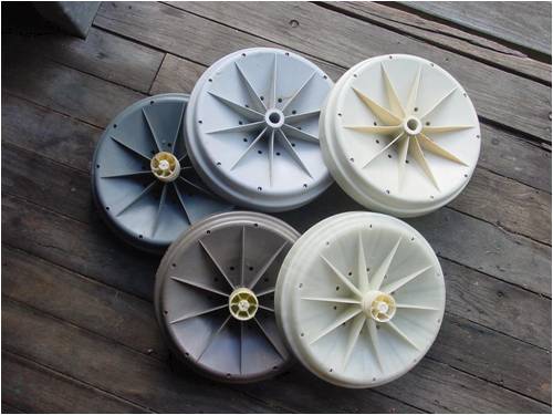

I came across the folowing rotor colours:
light creme the first single magnet rotors: ~10% less
creme speckled
common grey
light grey
translucent creme
speckled brown - best output: about 1amp more then grey
I did some test old single mags, creme against grey and the brown one.

The speckled brown type is more rigid as well. Better all round, but not very common.

here is a picture from different rotor colours
