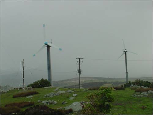

Well, I finally had to return to the windmills down at the other end of the island. These are the two induction grid tie ones.
I finally remembered the camera, and so here they are:
First from up the top of the hill:

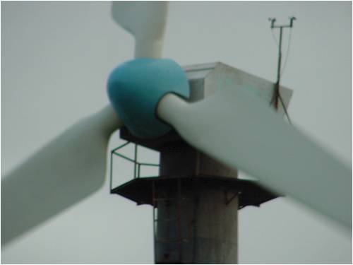

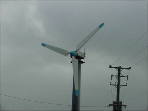

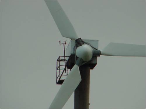

Here is a telephoto of the bigger one.. it is around 55 feet diameter... I'm not sure as the owner is not sure either... and he built it.... and I ain't gonna measure it either.:
Another shot of it. The blue tips are the tip flaps that go at right angles in an over speed condition.... very useful adjunct. The walking platform can be clearly seen.

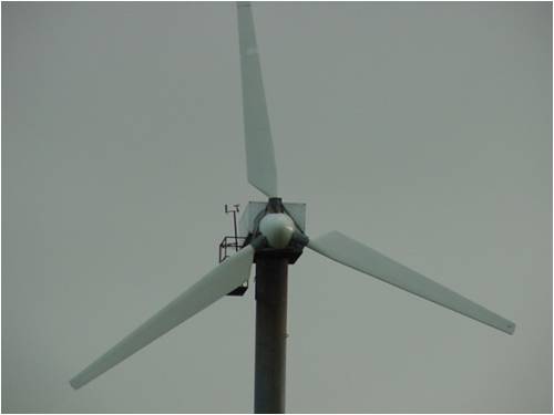

Here is the little one. it is only 30 odd feet diam. I was fixing this one today. It was in the auto return cable twist electronics. ... fixed. Even in mild winds in which it wouldn't start, if you kick start it with the main contactor, it putted along at 2-8 KW... not bad... thats in about 4-6m/sec messy wind... not coming from the west, but along the ridge top and
into it.... not good, or usual wind.

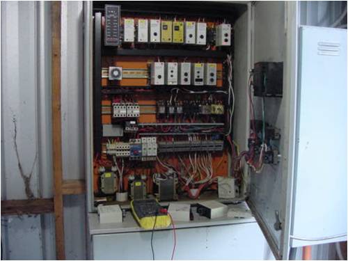

Here is the control system for one of these things. It is like auto electrical work... you know it's simple, you just can't find where all the wires go because someone used all the same colors..

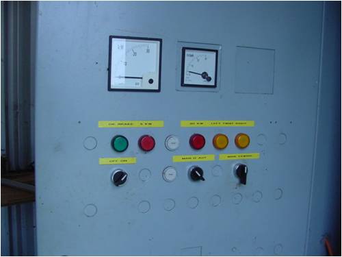

Looks better when it's closed though (means it's fixed)

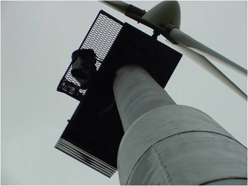

There's the owner installing the direction sensor I have just rebuilt.

Gotta give respect to the guy that built the 55 footer.. It's no small or easy diy project.

Janne,
He is a Danish gentleman. He was interested in windmills in Denmark.... a country which after the oil crisis of the seventies,appears to have became interested in windpower in a big way.
So some 25-30 years ago, he decided it was the way of the future, and imported the danish made blades and a control system from that era.
He is an engineer, and built the rest from scratch. I suspect he had the first grid tie induction machine in this country decades ago. The little one has been flying for over a quarter of a century now.
The odd thing is he knows very little about the aerodynamics/ generator relationships, and not much idea at all about the electrical/electronic bits either, but he managed to build the machines none the less, and build the second switchboard and control systems from the original control circuits he imported.....The Danes must have had good instructions, and he must be a good methodical learner.
The reason he does not really know how big the blade diam is... is it seemed unimportant at the time... you buy 60kw blades or whatever, you stick em on a big motor shaft... and you bang it up in the air.....whats to know????
He really was a solo pioneer in this stuff in this country.

The sky is the limit as to how you wire these things. They essentially all need to have the same basic attributes, but an almost limitless list of possible adjuncts can be added.
You need to know the windspeed, direction, power condition (freq, voltage and are all three phases present), shaft RPM... and your good to go. You then need the systems to pull on the brake (under a variety of shut down errors), rotate the yaw, control the twist condition.
All of those electromatic modules you see in the picture control a single aspect of it's operation independently. They all have adjustable time constants where applicable and set their internal relays accordingly.
Simply series the outputs you need for a particular condition and it's done.
In truth, a simple plc controller could do most of it ... but this was done before they were hip.
I probably would not do it this way, but having said that, this thing runs 24/7 for the last 25 years or so...pretty hard to argue with that technology I guess.
They are not what I would call big machines, but they mimic the systems of the big ones pretty well as I understand it (different electronics obviously)
