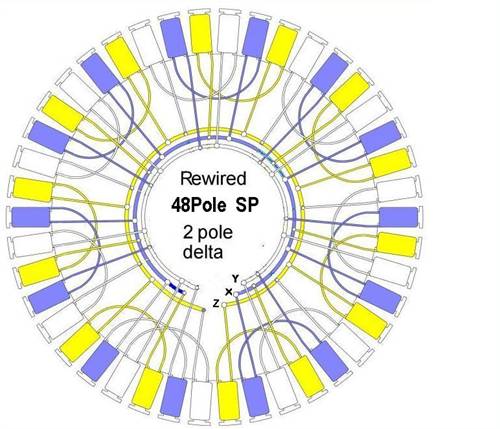

There is a drawing for SP delta only wiring.
cheers
Harald
PS: no garanties that this is correct, I am not yet perfect.

Hi
I mixed up the numbers.
It schould read 42 poles.
I am surprised nobody noticed or didn't bother.
cheers
Harald

Hi Harald,
Nice work, have you had time to run it yet?
This along with Glenn's staggered winding will be an interesting read .
I thought about the 48 "thing" ,but just let it go as I just know you are too smart to make a mistake.
Bruce

just finished wiring the last rotor of the LG's last night.
wired each phase different, I will measure only a phase a time and will multipy the output by 3,so only for delta wiring, in star wiring the efficiency is much lower and should be avoided. ( I would have to rewire for each test, that's to much.)
Configuration: 12P - all in parallel
2S-6P - 2in series-6 in parallel
4S-3P - 4 in parallel-3 in series
I have as well a new F&P 36 rewired in the same way to test it and compare. Now I need somebody to give me a hind how to put the data into a graph (which exel template ?) I used a "Line chart" from MS Word last time. This didn't place the rpms proper. See old listing. Hope somebody can help, please.
