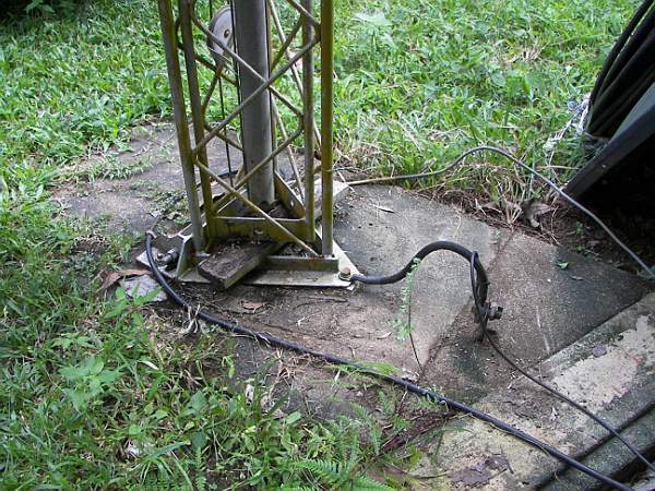

Seriously though, I think a grounding stake connected to the tower by a very heavy cable is the first thing.
I used 2x electricians earthing rods end in end to give 12 or 16ft(I forget exactly).
like this,
and for over kill.

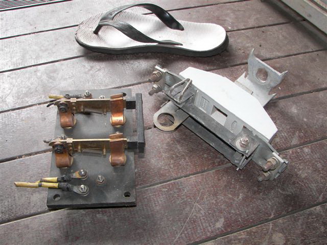

The secondly, "To Protect... Disconnect".
These big knife switches are great for slip-ring windmills, and for those without, simply unplug the untwisting connector to disconnect the battery etc.

Where do you get those "knife-switches" by the way --most of that stuff has gone to the metal re-cyclers years ago ??

Yes. The copper & brass one was a bit of a find for sure.
The one most available would be the one on the right. I believe it is your standard "pay your bill or we'll cut your power off" switch that is mounted on the pole outside your house. A lot of that stuff is throw out when they upgrade power poles. It's just a matter of keeping your eyes open as, in this area, it often sits on the ground where they've done the work waiting for their dump truck to dispose of the stuff.
Why not a strip of insulating board, a couple of brass bolts and a removable copper bridge?

Excelent, that tower is from a crane? Nice "strike trap" (good ideea) and switches.

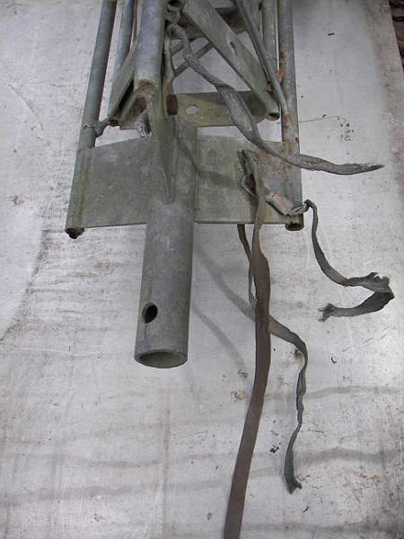

Posted: 09:35am 25 Jun 2007
G'day Vasi,
Tower is not from crane. Both are radio mast. The top one was severely damaged when blown down in a cyclone may years ago. I bought it as scrap then rebuild it. The second one I've yet to erect. It's for the the wind gen in progress. Also a crank up radio mast. Mine are small @ 17.5 Meters & 22.5 Meters. Would love to score one of the tall towers to get well above the trees.
