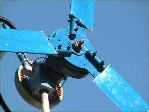

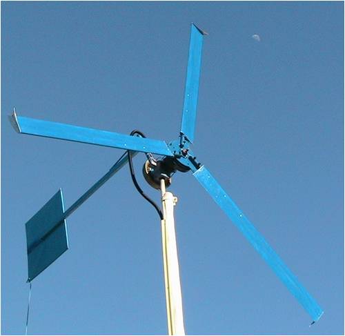

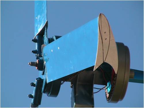

Jim, here are some pics of what have done so far with new blades. Am using 1.5m length which makes overall dia. 3.4m. Have used 1/4"plate and XH pipe for sockets and trust this will hold. If not will go to a 1/2" plate base of an old microphone stand.
Am happy you got your blades together OK.
Would like a nose cone but where to get Jarbar?
Peter

Pete thanks for all the great photos. That's a fine mill you have there. Just as soon as I get something
that resembles a mill I will post photos.
