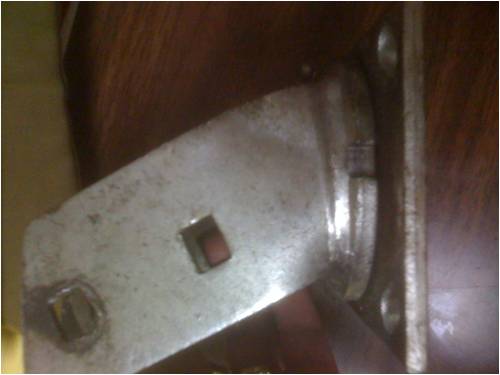

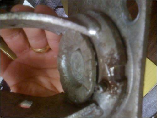

Hey guys, I just come across a caster off of a dumpster that is heavy guage galvanized steel with ball bearings that have a grease fitting. Its the dumpster that restaurants use to haul their garbage to the main dumpster outside.

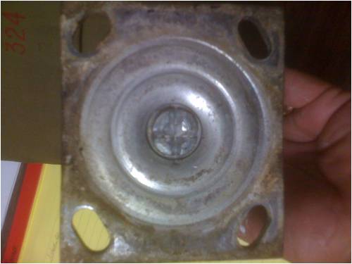

Look at the third picture, it won't last very long, guess it was attached to a dumpster for a reason.
Made for downward compressive loading, that spread bit in the middle will wear out quickly and your turbine will fly away, you aren't my neighbor are you?

Hi Windlight, the spread bit does not move the part with the ears rotates
on the base on the bearings, the shaft is 3/4" so after I weld the bit to the
base plate there won't be any problem with the bit wearing out. What is
great about it is the bearings ( stainless steel ) and a grease fitting.
Everything has to be modified a little

OK that's a bit more robust than it appears in the photo, hope it works out for you.
