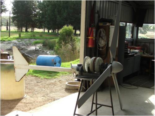

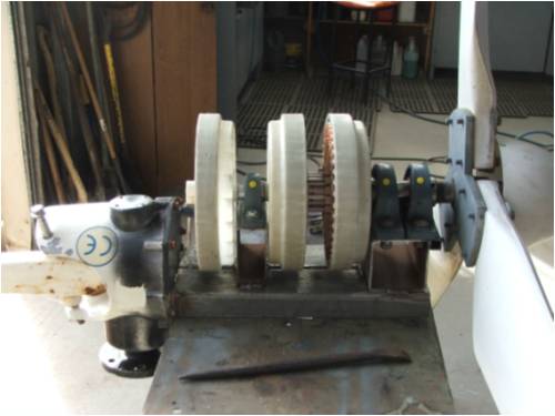

some photos of progress so far.

Thats a good looking machine you have there PLUGGY can you come build mine for me?

the mill looks like a chop/shop job on a chinese type mill. How far ahead of the tower pivot is the blade rotor? Looks quite a way, and this will change the furling.
Hi all
The mill is an Modified chinese that dident work properly (49v in a cyclone).So chopped it up for this project. As you say the furling has probly changed as hub is approx 200mm further forward.I suppose there is no way to test this on the ground.Trial and error when flying?
I am making the tail larger as the original is to small ,so this will also have some effect? The question is How big does the tail need to be?. Still lots of things to work out.Main thing still to work out is the wiring of the stators.
in the pic the end spare rotor is a stripped out hub which i plan to make into a manual brake.
Rgds CarlEdited by PLUGGY 2009-04-18

BUT you see the shaft in the pics,that is the original rotor shaft so as you can see there is no turning back Unfortunately.
The original mill rotor was a brushless 6 neo magnet rotor .Has 3 slip rings on the yaw pivot.
