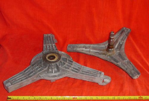

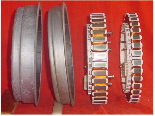

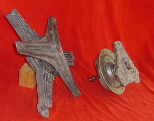

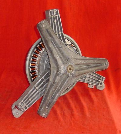

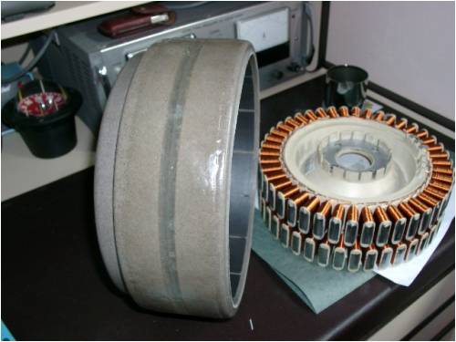

I came across another LG smartdrive from a frontloader.
Quite different from a top loader, smaller motor, same diameter, and totally different bearing holder. I think the frontloader has a 500 watt motor and the the top loader a 1500 watt???
Both have oversized bearings compared to F&P, and there would be very little to machine for windmills, both drumholder could be used as they are to mount blades on them, they are very strong.

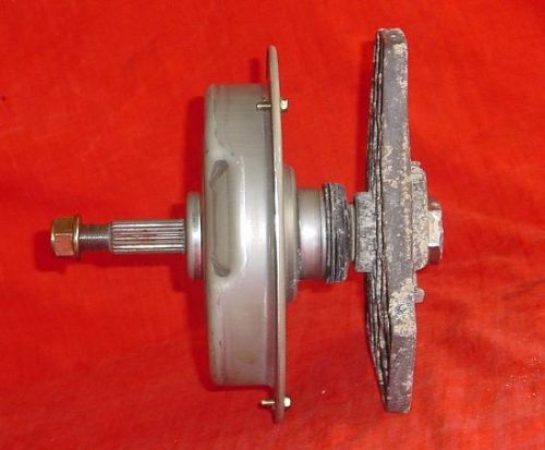

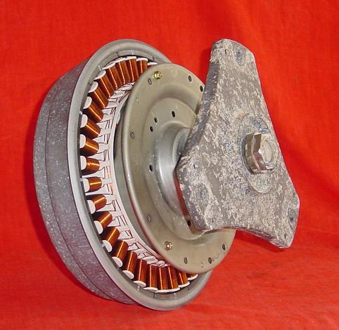

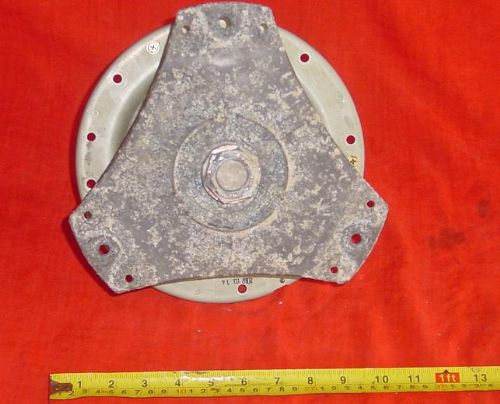

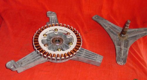

here are some pics:
Toploder with original flat mounting plate
Toploader complete
left frontloader right toploader
Frontloader, left statorholder, right rotating drumholder, perfect for a horizontal wind machine
frontloader
frontloader

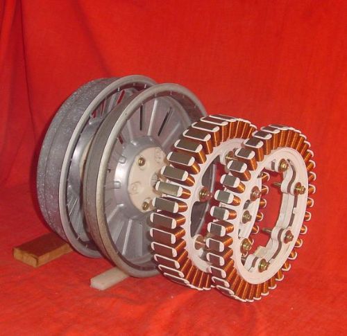

If the rotors were set up facing and in contact with each other's magnets would this increase the total flux of the magnets.ie greater than 1+1.As it appears that stacking of the stators would be possible due to their flat construction.As compared to the F&P's with the dished center's which need more space to achieve this.With the F&P's I have been considering making a spacing ring out of the magnet part of the plastic rotor.ie machining the back off a rotor leaving both edge's of the magnets exposed.The magnets would self align by polarity rotor to rotor with maybe an external band clamping them concentrically. Creating more room for the stators stacked height and maybe more flux.
Anthony.

Posted: 09:33pm 11 Apr 2009
Like this F&P set-up. never got around to testing it fully ,,I think back and think it was a bit big and sort of scraped on one of the stators,,but I'll give it a try again ..
Bruce

Posted: 10:50pm 11 Apr 2009
Exactly Bruce!.
If you had another rotor for the other end and machined the center out of it it could then hang off the bottom of my VAWT.The cable loom could exit out the new opening and down to the ground.Which gets me back to an earlier posting and that is if 42 poles x 3 stators were mounted so. Would it generate the same power at a third of the speed of an equivilent HAWT with one rotor/stator.And how would you wire it.I take your point about concentricty and keeping stator from deflecting towards the magnets pull.

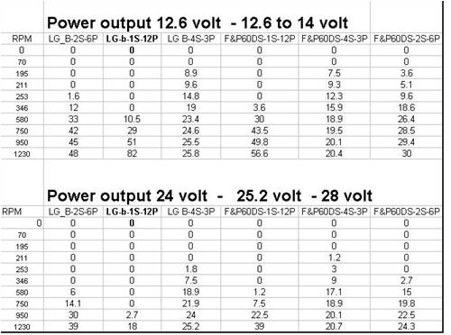

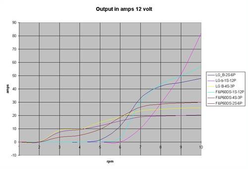

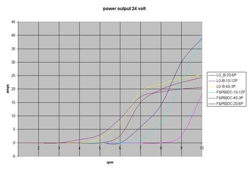

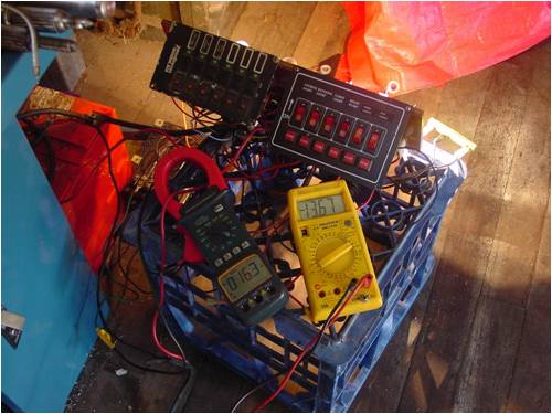

I finally got around and did some test last week.
output data is for the wider LG and the 36 pole, non cogging F&P 60DC 0.6mm wire(named it accidently DS)
The one piece shaft assembly from the smaller LG (see pic.) bracket didn't fit in the lathe and I didn't want to cut the shaft off, it's to perfect for a blade holder.
I measured only one phase and tripled the output
So all measurements are for delta wiring!
I need from somebody a hint, or where to get or how to use an exel chart template to accomdate the unregular rpms of the lathe. The rpms are not regular spaced on my lathe thats why the chart is misleading easy, as well the curves are not proper displayed.

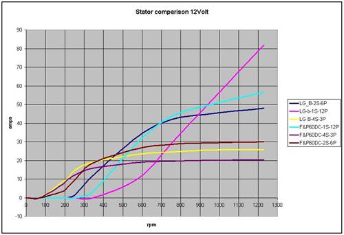

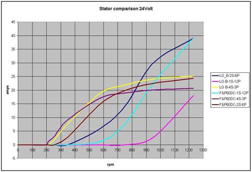

Hi harald,
You need to do a scatter plot, not a line plot.
Use the rpm in the first column, and the other data in successive columns.
Deleted graphs to avoid confusion. Glad U were able to post bettter graphs below.
The LG has similar issues to a F&P, but this would be expected.
Gordon.

Posted: 02:33am 09 Jun 2009
Thanks Gordon, looks much better.
I expected more power at lower rpm from the LG compared with the F&P.
cheers
Harald

Here are the corrected charts, thank's to Gordon.
BTW: retcifier was via schottky diodes
Harald

I did more poweroutput tests in the last days:
I have connected all three phases of the F&P 60DC 1S12P and the test results were disapointing compared to the previous single phase test.
Measuring only one phase and tripling the data is not correct. I think the magnetic saturation plays a negative role in the higher rpms.
I will post the data in a new topic because it's a F&P data result.
