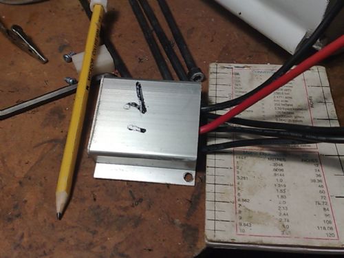

One problem I can see is that the regulator is said to cut out at 14.1v and back in at 12.6v. Is the load removed from the generator at 14.1v ??? (My Topo 45a dump load only cuts in at 15v).
Should I just replace the regulator/rectifier mentioned on other threads with the added capacitors (this must be done at the generator as there are only 2 slip rings on this model!)and connect to the battery via a pl-20 or similar and use this to dump instead?

I to purchased on of these mills ,gave me grief right from the start ,in the end I pulled the tail off and cut all the wires from the electronic regulator . fitted a rectifier from Virtual village . 80 amp 1000 volt with a heat sink made from am aluminium plate ( 8mm thick ) tucked it all back inside and connected the dc side of the rectifier to the wires that attach to the brushes that run on the slip rings.
You can connect through the PL 20 but when the wind really gets going this mill can make up to 40 amps ,all being very briefly, so be aware of the max this can put out.

This shows the rectifier/regulator unit
What goes around ....

On another note, I plan to replace the current rectifier/controller unit (this is inbuilt). Is it better to use one high current bridge or three smaller units (the gen is 3 phase). I would like to try your voltage doubler as I only have 5m/s average wind. Is this viable on a 12v system.
fernbrae 1 wrote.....
http://www.virtualvillage.com/Items/007901-004?&caSKU=007901 -004&caTitle=3%20Phase/DC%2075A%201000V%20SKBPC%20Bridge%20R ectifier
The above link is the rectifier I used for the wind mill
I mounted it on a 8mm piece of aluminium and pulled out the slip rings ( these gave me grief ) drilled a holt out the body and run the wires outside ( when inside without the slip rings the wires twisted up )
So now it seems to work fine .
