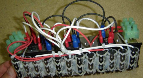

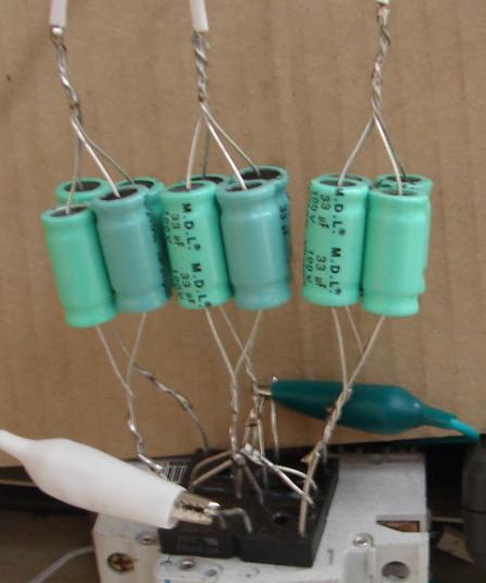

here are the caps and rectifiers I put together for the voltage doubler on my F&P mill. These were 66uF[2x33uF,100VAC, from Jaycar] F&P frequency dictates smaller caps, approx 1/4 the size of those required for a 500W chinese mill.

The caps do dissipate power, so it is important to not glue them together tightly. I use hot melt glue on the larger can type caps, where the gaps are quite large, and only to tack the caps together at the ends.
